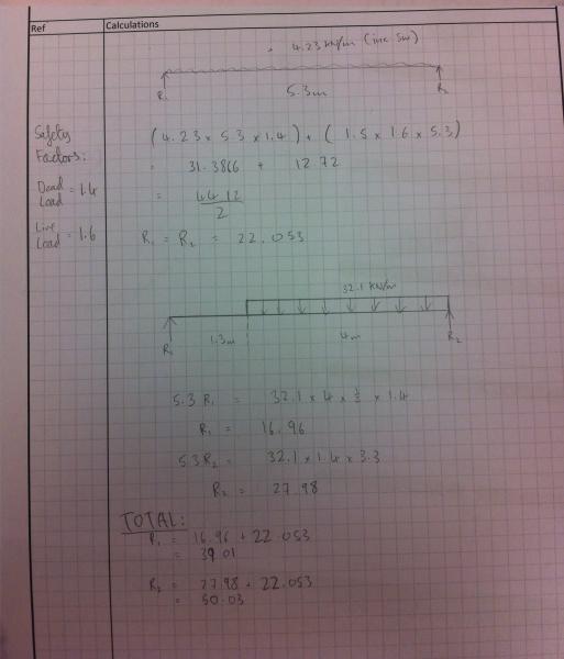

Hi,
I am designing a beam to replace a load bearing wall.
I have produced 2 separate UDL diagrams which, one for floor load and one for wall load. I am trying to find shear force and bending moment as in one for the total of the two diagrams. I know how to do it if the loads are spread across the whole beam but when just part of it is loaded, that's where I am a bit confused.
thanks
Here is what i have so far attached:
