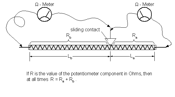

I'm just all the more confused now. If I split the potentiometer to 2 resistors, don't they both must equal to the value of I set the potentiometer at? According to the question IMO it's 2 volts TOTAL. i.e. their sum is 2 volts and they split equally...the way I read it
The physical implementation of a potentiometer has a resistive strip whose total end-to-end resistance is the "value" of the potentiometer. Each end of the strip has a contact. There is a third contact that can slide from end to end along the surface of the strip. This contact "divides" the strip into two portions according to the slider location. The resistance between the sliding contact and an end of the strip is proportional to the length of strip lying between the contact point and that end. The portions can be any ratio of lengths (and thus resistances) but their sum must still add up to the net length (resistance) of the strip.
From the original circuit diagram it looks like the potentiometer can "tap" any value between 0 and 4V.
Ahhh perfect explanation and diagram. See, I thought that a potentiometer is a device that regulate the amount of resistance of a resistor. But it just regulates the spread of differences...makes sense.
The connection is 25% along the length of the resistor element (i.e., measured from the earthed end). So now the op-amp's (+) input is being supplied 25% of the 4 volts.

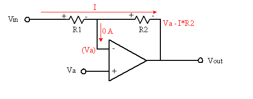

Now, let's look at the network connected to the op-amps (–) input. There's Vi at one end of R1 and Vb at its other end. So what is the expression for current through R1? Use Ohm's Law.
Ir1 = Va/R1 = 1/3000 = 0.333 [mA]
Next, look at R2. What is the voltage at each of its ends? So determine an expression for the current through R2.
The voltage at R2 must be 3 [V]...as 4-1 = 3[V]
Ir2 = Vr2 / R2 = 0.5 [mA]
The op-amp, as always, draws practically no current into either of its input terminals, so we are left with the customary relation, current in R1 = current in R2. So equate your expressions for these currents, and solve for Vout.

Correct. Now, since the input to the op-amp does not draw any current, what happens to that 1mA?
That's not the Ohm's Law I know. :rolleyes:
My Ohm's Law says that the current through a resistor is 1/R times the voltage difference across that resistor. You need to establish the voltage difference across R1. Re-read what I have quoted at the top here.
It's -5 V actually :smile: A small algebra sign issue.
Note that you don't always have to trace out a complete loop to apply voltage sums. If you know the potential at one location in a circuit and have all the potential changes between that point and another point, you can simply add up all the changes to determine the net change from start to finish.
In this case you know the potential at b is Va, and have determined the potential drop across R2 to be VR2 = -I*R2. So Vout = Va + VR2.
A quick way to analyze this type of op-amp arrangement is to proceed as follows:
1. Determine the "reference" potential at the +input of the op-amp. This will also be the potential at the -input.
2. Determine the current from the input that flows through the input resistor due to the potential difference across it.
3. Determine the potential drop across the feedback resistor due to this same current.
4. Add this drop to the known potential at the -input to find Vout.
