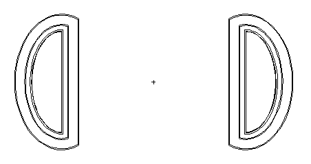

the radius from the symmetry to center of the plasma is about 6.2 metres and the minor radius is 2 metres
Can you guys help me to make the plasma geometry for MCNP?
the softcode of plasma geometry
i already attemp to make it but the shape is not too D shape :(

Actually i am doing my undergraduate thesis with this topic and i have some problem to make the D shape of the plasma in MCNP. The program i used to design the plasma is MCNP5 with the help of VISED.
i have trouble to make this geometry

Have you got the MCNP user manual there? It has a tutorial and several examples on how to use the basic features.
Which version of MCNP are you using? It's all properly registered and licensed right? That is an export controlled code.
Likes berkeman

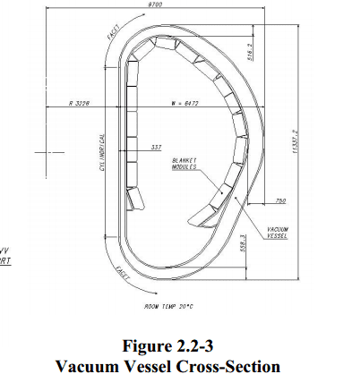

Thanks for the reply, currently i am using MCNPX with the visual using VISED. i have trouble to make the Faceted geometry of ITER..could you give me insight? thanks
The first insight is, only use vised to view your input file. Don't try to use it to build the input. It will just crash on you constantly and confuse you and be a whole lot of annoyance and not fun. Also, if vised crashes, look for the files it creates. Make sure your file is named something different from the files vised creates. And after a vised crash, delete those vised created files. They are often corrupted during a crash.
After that it all comes down to reading the manual. I would suggest that first you go through the whole tutorial example in the start of the user manual. A bit tedious, I know. But it really will help.

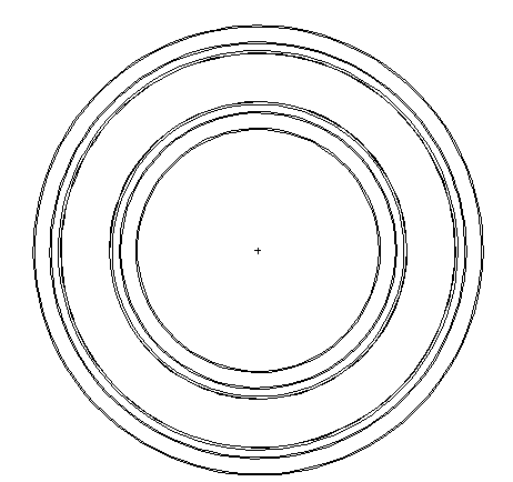

thanks for the response sir... yep i make the input at my notepad and to visualize it, i am using VISEDX, i am already make the geometry like the pictures i attached below. the thing is i still can't make the geometry as perfect as the ITER faceted section like below attachment..do you have some advice to use what kind of geometry to use? thanks very much
