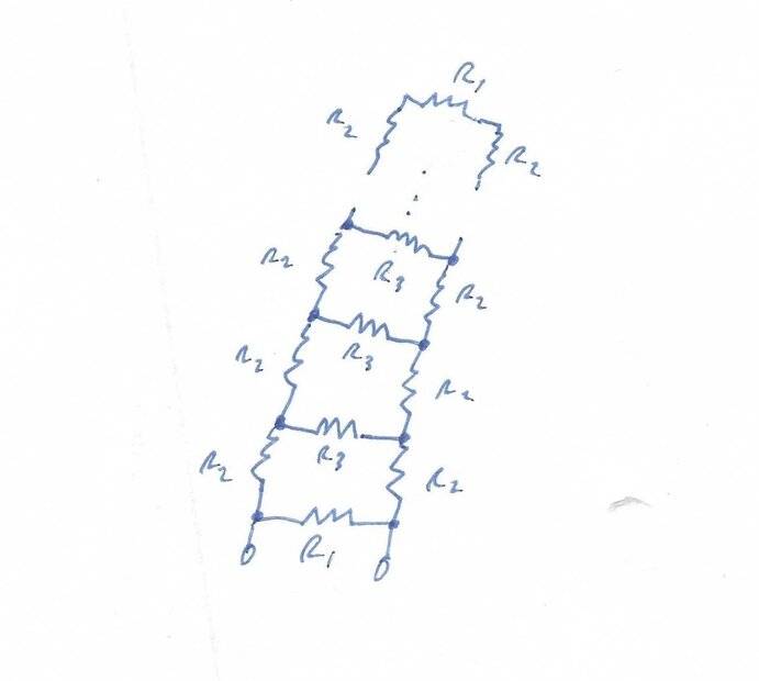

TL;DR Summary: I have to find an equivalent resistance of the circuit below, dependent on the amount of ##R_3## - resistors.
Here is the circuit:
I think there is no general solution. When I want to calculate it, I have to do ##((((R_1+2R_2)^{-1}+{R_3}^{-1})^{-1}+2R_2)^{-1}+{R_3}^{-1})^{-1}...##, so it is kind of crazy. Is there any general solution dependent on the amount of ##R_3## - resistors ##n##? So something like ##R_{\mathrm {eq} _n}=....##.
Google "ladder circuit". You will find methods for dealing with problems like this.

My first step would be to leave out the two R1s. Those can be put back in later.
The resistance of the remaining system is a function R(n). Can you figure out the relationship between R(n) and R(n+1)?

Yes, I did it and I made an approximation when ##n## is big, so we can say that ##R_n \approx R_{n-1}##, similary as when we solve an infinite ladder circuit. Then it was easy to solve.
