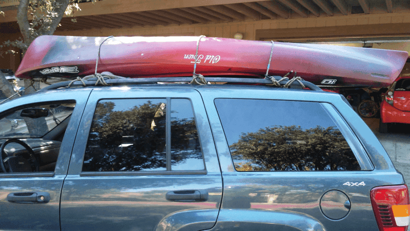

I have a boat that weighs about 100 lbs. and is 10’ long. I’d like to load it on my pickup rack in the manner shown in this (and many others) video, but without having to purchase and mount a winch.
I’m fairly certain I can get the boat upright. The portion I don’t know how to calculate is once it’s standing up. Pulling the transom away from the truck should be fairly easy but from there to the upside down horizontal position eludes me.
The rack is 7’ from the ground. The transom is about 2’ tall. So when the boat is upright, the balance point will be close to the rack.
I suppose I could attach a block and tackle to the front rack and pull the bow with it.
How would I calculate the maximum effort required.
Thanks for reading. I look forward learning how to answer this question.

Also, this is my wife's kayak that she is able to load up onto the top of my Jeep Grand Cherokee by hand using leaning leverage from the back of the vehicle. The roof is probably 6' tall and my 60 y/o wife is about 5' tall. Her 10' kayak weighs about 60 pounds (so I can lift it up and onto the Jeep roof rack no problem by myself from the side, but she often goes kayaking by herself).
Can you post pics of your boat and vehicle? Are you comfortable lifting avout 60 pounds to leverage your 100 pound boat up onto the back of your pickup rack (using good lifting technique)?

Does your rack like these ones?
The problem is that the vehicle is 7 ft high and the boat is only 10 ft long. That is a difficult lift for a human body.
Like the first one. But my boat is much smaller.

I think, but don’t know, that I don’t need a lifting rope at all. I hope I don’t. Thus the question here about the effort required.
To stand the boat up on the transom will take less than half the 100 pounds. But to then lift the hull to the point where you can begin to slide it forward, you will need to lift the entire weight of 100 pounds.
There is a safety issue here. On the day you cannot quite lift it all the way, you will have the boat fall back on you from above. At that moment, you will be at your most vulnerable, and will probably be physically injured. You will also notice the mental effort necessary before lifting 100 pounds up 7 feet, becomes more difficult to attain.
A winch and bridle operates to protect the operator in several ways. It keeps you out of harms way, and takes the weight when you need to stop. By selecting the bridle attachment points, it will also control the orientation of the hull during the lift.

Another part I didn’t explain well: There are two ropes attached between the transom and the rack. As the boat is rotated to vertical, they are holding the full weight, creating the pivot point. I would not be lifting the full weight at any point.
Those two ropes change the game, so long as they are attached to the top of the transom and do not stretch.

The boat is 10' long and the rack is 7' off the ground. That means that as you lift the transom up and out, only 3' of the bow, which is the lightest part of the boat, is going to be supported by the pivot point at the rack - at best 20% of the weight of the boat, so you are still going to be lifting over 80 lbs above head height.

So if you lift the bow by hand to vertical (which is probably easiest for control) that will be <50lbs. The next move is the tricky one then
Truly, the CoM coordinate and the boat need to be considered in 2 dimensions. The CoM is likely closer to the floor of the boat, which means it is offset from the pivot maybe a foot or more. This increases the torque, and the point application of the force on the extended body also becomes relevant.
Basically, you can disregard that simple 1D beam model I provided earlier.
