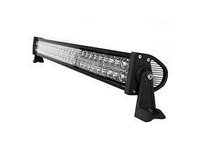

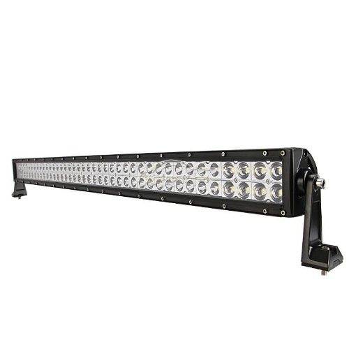

I need guidance in the explanation of utilizing LED light bars for a different function then designed. I do stage production, sound and lights for concerts and would like to adapt these LED light bars to "blind" to crowd.
My issue is that each light bar operates 12-30 Volts DC @ 300 Watts. In order to power and control with our DMX software (standard lighting control language/interface for stage production) I would need to build a more complicated device for each light bar. Meaning I would need DMX control PC board, relay to handle high wattage, power source, XLR in/out jack for communication, IEC jack, fuses, housing etc... Multiply by 4 costs add up FAST.
My thoughts include:
A single high wattage (24volt @1500watt) DC power supply to power all.
Then I thought, can I wire in series to 120AC, this would put me at 30volts AC for each fixture. This would make controlling ALOT easier and cheaper because I could use an off the shelf DMX relay switch to control the bars.
I hope I explained well...
I am looking for any suggestions.

To convert that AC to something better resembling DC you would need a rectifier. But even then it would be a pulsating voltage sweeping from 0v up to 42v and with the light bars designed for 12-30v DC they may not be happy with this.
Placing all 3 light bars in jeopardy is probably not a risk worth taking.
Another thing to keep in mind is that the line voltage is specified in RMS, not peak value. In modern times the standard nominal value for AC voltage across North America is 120 V and is supposed to be maintained to within +/- 5%. Thus it can vary from time to time and place to place depending upon local grid circumstances from, say, 114 V to 126 V RMS, meaning that the peak values can range from 161 V to 178 V. So what you thought was a nice division of 120 V by 4 to yield 30 V per unit actually could end up delivering between 40 V and 45 V, with 42.4 V as the nominal value. That would be the voltage peaks. The average voltage delivered would be much lower (peaks make up a tiny part of the AC cycle).
To judge how the individual units would fare under those conditions we'd need to know more about their internal wiring and the LED device specs. We have no idea what insulation or grounding precautions have been observed for these units if they are intended to be run on low voltage DC; It would not surprise me to learn that one supply connection is directly wired to the metal enclosure.
As a practical solution, placing several loads which are expecting low voltage DC in series with an AC source has too many issues of safety and unknown behavior to be recommended.

Many of those light bars have constant current driver circuitry inside. Note the 12-30V range. Running them in series may not work very well if at all. They also come in 120VAC versions that tend to be cheaper.
