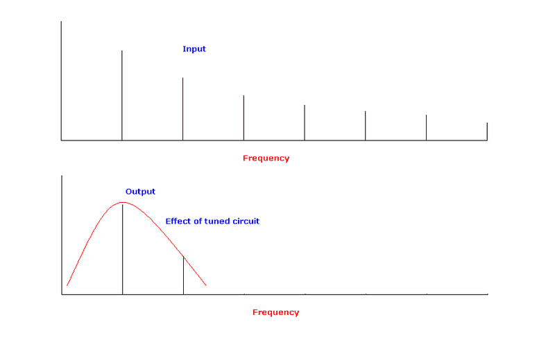

In fact, LC circuits only oscillate briefly and under very special circuitry. "Ringing" on pulsed inputs is one.
Usually, tuned circuits just modify incoming waveforms like this:
This shows the harmonics of an incoming waveform. If you remove the harmonics the waveform looks more and more like a sinewave. If you remove all of them, it will be a sinewave.
A tuned circuit isn't perfect and it may remove all but the lower harmonics, producing a rounded version of the original but without the fast rise and fall times of the original.
You can tune the tuned circuit to just a harmonic if you like. This would give you a sinewave at the harmonic frequency.
