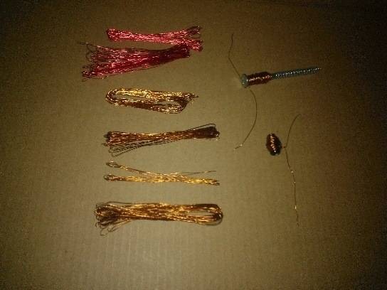

I have a small collection of wires and two small scale electromagnets that don't seem to work, can you tell me what I may have done wrong? Also, I heard speakers have an abundance of good wires in them, is this true, and is it worth it?

At the ends of the wire you need to remove the enamel e.g. with sandpaper, before you connect it to the battery. Also, do you have a multimeter to measure the resistance of the wire? It could help with making the magnet as strong as possible.

I am going to sand down the wires later today, but I do not have a multimeter. Does Radioshack/Best Buy carry those?

Nevermind, I found some, but I don't really know how to use one and how the resistance correlates with the strength of the magnet. I am doing to this project to learn more about this topic and to pass time.
It is a good way to tinker with the subject. Yes Radio Shack will have a basic meter, digital multi meter (DMM) - look out for the VERY cheap ones, they may take a weird battery, but you do not need much for these types of experiments.
What are you using for power, a battery?
If you are able measure the resistance (with the DMM) the expected current that will flow will be the Voltage (of the battery(s) ) divided by the resistance. I (current) = V / R.
Another way to get the enamel off is carefully scrape off with a razor knife.
Lastly - a very sensitive indicator - so see if the electromagnet is working is a compass - useful for when you are just starting out.
good luck.
Likes 1 person

If you know the voltage and current you want to use and the volume of the copper coil, you can calculate what wire size you need to get a coil with the right resistance.
I just bought the 315 ft thing of cord and a spdt switch. I also just found a vacuum and now it's a pile of plastic with no motor :). I was wondering if I can use it for any projects or just scrap it for wire?
Wire is cheap. Don't scrap the motor without good reason. 15 years from now you may be glad you kept it when you use it to crack some walnuts.
Looking at your kit, you have 3 wire sizes.
22ga copper, 0.161 ohms /10ft
26ga 0.408 ohms/10ft
30ga 1.032 ohms per 10 ft
(from http://www.cirris.com/testing/resistance/wire.html)
So, 1.5V D cell and 30 ft of #30 would be about 0.5amps (calculate it). #30 will heat to 80C at 2 amps. (look it up). You can do different calculations. An ohm meter will allow you to measure resistance directly, and an ammeter will tell you the current through the coil. (multimeters have both modes)
As for the electromagnet strength, you can calculate it based on current and number of turns. http://www.daycounter.com/Calculators/Magnets/Solenoid-Force-Calculator.phtml
