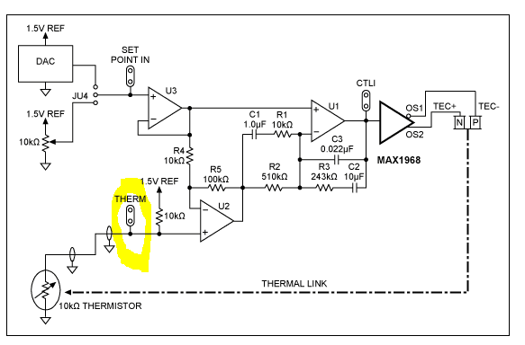

I talked to the colleague who did this years ago--he confirmed that he used a grid scan, not PID. So I'll do that. For my PID project I'm going to control a thermo-electric cooler but with op amps instead of an arduino. There is a good guide here https://www.analog.com/en/technical...d-compensate-a-thermoelectric-cooler-tec.html
But I am confused about a symbol found in several places on the schematic:
What is that THERM symbol? In the other uses it appears to be some way of adjusting something. Thanks for the help!
They look like test points to me. Is there an image of the circuit that you can look at to see if there are little metal probe tips sticking up at those locations?
No image of the circuit Test points make perfect sense, thank you! This is going to be a really fun project to build.

BTW, there is an error in the input circuit for U3. Can you figure out what it is? (Kind of weird for AD to make an error like that...)
The feedback has no resistor! It goes straight from the output to the negative input of U3. Weird.
No, that part is okay. It's a common unity-gain buffer configuration for an opamp...

Funny you should mention H&H -- we discussed this issue in an old thread about the "Bad Circuits" in H&H:
https://www.physicsforums.com/threads/bad-circuits-test-your-knowledge.178516/post-1390820
The issue is that when you have almost no wiper current for a potentiometer, the contact corrodes over time and the pot setting becomes unreliable. Pots will specify a minimum wiper current to keep them reliable over time, so any time you see a pot wiper going straight into an opamp input, you need to check the input bias current spec in the datasheet to see how it compares to that minimum wiper current.
I checked the spec for the opamp that AD is recommending in that app note, an its input bias current is in the pA range. :wink:

"corrodes over time" isn't a huge concern for me but if you have a correction to make to the circuit I would welcome it. I'm going to build this, take a video of it working to put on LinkedIn, then take it apart.
You should be able to find alternative configurations of pots to minimize this problem in that Bourns Handbook that I linked to. There are several ways to configure such a circuit with a pot and a couple of resistors to eliminate the problem.
And yeah, if you're going to put this on LinkedIn as an example of your work, you will definitely want to fix that before posting. I think most analog EEs would spot that issue.

Another interesting aspect of the circuit is no DC feedback around U1.
The overall circuit appears to function as Bang-Bang (hard on - hard off), PID controller.
Either clever or another case of a Bad Schematic.
@Galoot44, please let us know how well it works, some oscilloscope traces of the TEC voltage or current during operation would be especially useful.
Yikes, I missed that. The path U3 output -->U2-->U1 inverting input looks problematic. If I had the time I'd try simulating it, but maybe your bang-bang guess is correct.
This is normal in a closed loop controller. It's an integrator which is designed to eliminate DC errors, using (nearly) infinite gain. The DC feedback mechanism is the temperature of the oven (make heat -> measure temperature).
Likes Tom.G
I don't think this is a bang-bang controller.
U2 generates a target voltage for 'therm'. The error voltage is amplified, then after passing the U1 PID controller, goes to the voltage input of the MAX1968.
The MAX1968 is a voltage controlled, high efficiency, switching, bidirectional current source, for the thermoelectric cooler/heater element, it has additional inductive components, not shown in the post #8 diagram.
Likes Tom.G
