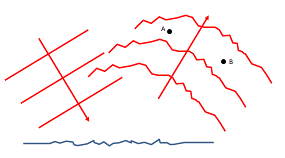

my2cts said:
It monochromatic light comes from a diffuse scatterer there is no spatial coherence and an intereference pattern is not visible.
Let's observe a picture I attach. The incoming wave has both perfect temporal and spatial coherence. As I have said the irregularities in the surface only change the structure of reflected wavefronts, it may look as ugly as it can take but as long as there is no change in the surface structure the reflected wavefronts will stay as they are for all times. If one observes what is happening at two points A and B in space, since the reflected wavefront shape that traverses these points is unchanged in time the phase different between those points will also be kept fixed. And now let's remember that what prevents us from seeing interference pattern is that if it fluctuates very rapidly, this rapid fluctuation of interference pattern must have been caused by rapid change in the state of the source. So what if the source state doesn't undergo any change, the emitted wavefronts won't undergo any change either.

  • #33

  • #35
Unfortunately, that picture gives the wrong impression of what actually happens to the incident wave fronts. Each piece of the irregular surface will give rise to a set of wavelets (Look up Huygen's Principle) and all those wavelets will add together to give a pattern which is far less 'detailed' than what you have drawn. It will, in fact, produce a smooth looking shape that is curved - showing that the original plane wave front has been diffused. It helps to bear in mind the basic rules of diffraction - the relevant one here is that small structures (i.e. the irregularities) produce broad diffraction patterns and it is only large structures (like pairs of Young's slits, separated by several wavelengths) produce fine structured interference patterns.
