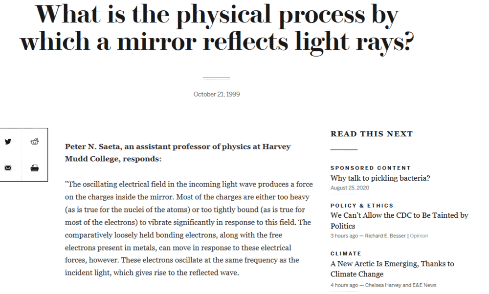

We know metals reflect microwave. One way to look at this is considering an eddy current formed inside the metal that cause the reflected EM Flux.
When glass reflects light, does something similar happen? Can we have eddy currents (or something analogous) with light since that's also an EM wave?
Can you give a reference for this? EM reflection at a conducting surface has to do mainly with the E-Field, not the B-Field, AFAIK...
https://www.scientificamerican.com/article/what-is-the-physical-proc/
I think it's just another way of looking. Even eddy current is an electric current flow that's causing an opposing magnetic flux.
I can take a look, but image something like this. What happens when you place an inductor right above a metal which has 0 resistance (perfect conductor)? eddy currents are formed in the metal that cancels the magnetic flux from the inductor. This is in effect like reflection of flux from inductor at the metal interface.
No. Please review what Eddy Currents are and how they are generated. Thank you.

As has been pointed out, eddy currents in an object have nothing to do with reflection
It's not a different way, it's just a plain wrong way
