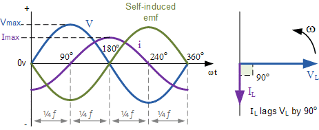

When we have ideal inductor or ideal capacitor, the current and voltage are out of phase, shifted with +/- 90 degrees.
So there will be moments in time, when current will be zero at maximum voltage and moments when voltage will be zero at maximum current.
Without current there is no magnetic field and without voltage - no electric field.
http://www.electronics-tutorials.ws/inductor/ac-inductors.html
There is plenty of electric and magnetic fields in wires regardless of voltage. About as much positive as that of negative polarity, so they superimpose and cancel out on average or macroscopically, but microscopically fields are already there.
I don't think the question is about complex systems, fields cancellation and net result, but really about single elementary particle. I'm not sure whether such particle is necessarily supposed to be a "magnetic monopole" or not.
