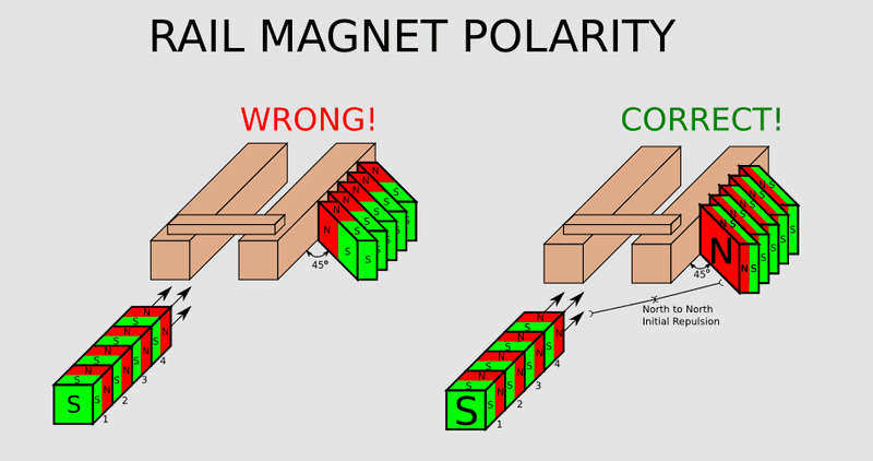

Can magnets be used to send a metal ball through a pipe?
In summary: For now just enough to shoot through a thin piece of plywood, maybe several mm thick. Then stronger later on.
Alanay
61
To elaborate more on my question: Is it possible to send metal balls through a pipe with magnets arranged a certain way which could hit a target with force. I've seen something similar done before but I think the ball was also a magnet, is that the only way possible?

Any that I can buy online or from a general hardware store. Can you give me an example with what kind or arrangement this can be done? I was hoping to place loads of magnets on 4 parallel sides inside a pipe. Would the magnets have to be 2 by 1 something and then place diagonally like I have seen in videos?

Like I said it doesn't matter, just tell me which ones can be used. I found this image though, do you know if it is accurate?

Thank you, do you know if 30 x 15 x 5 mm magnets with 10 kg force stacked in rows as shown in the image above will be too much force or not enough?
Here is what I'm thinking of buying.
To be stacked in rows to send down a ball:

As far as I know, permanent magnets can't provide any acceleration in this kind of setup. The repulsive forces will equal the attractive forces as the magnet passes through the tube and you'll just get the same output velocity as the input.

I'm talking about something like this:

I looked at the video, and what I think is happening is that the two guys put energy into the system when they bring the "shuttle" magnet towards the rail. Then it gets propelled through the rail, and the friction at the end makes it stop. Otherwise it would have started returning.
