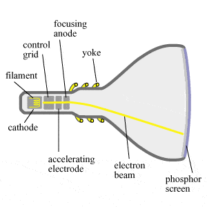

Are you familiar with how a Cathode Ray Tube (CRT) works? In a CRT you have a single cathode emitting the electron beam, and a large anode area that the electron beam is swept over using magnetic deflection to paint the picture on the phosphur-coated anode. You could divide the anode area up into multiple anodes if you wanted, each with its own bias power supply with respect to the cathode voltage.
Why is your vessel filled with argon gas? That will limit the mobility of the electrons... What voltages are you wanting to use to accelerate the electrons?

The answer, in general is that you can have as many electrodes in the system as you want. The only caveat is that the PDs between the carious Cathodes and Anodes and the Electric Fields need to be right or one anode could hog all the current. The electrons leaving a cathode will naturally spread out and they will follow different paths unless you focus them in some way.

i was thinking about argon plasma in a tube and i know that breakdown voltage is all about the distance between electrodes so i was wondering if a set of anodes will help with this issue. say a tube 10 meter is to hard to establish because of the distance between electrodes but if a set of anodes is applied along the tube it will make it easier. or that what i had in mind. still not sure

This topic is quite a sophisticated one and I think it would be better if you learned some before leaping in here. The problem with plasma is that it is non-linear (V;I characteristic); the more the current, the lower the resistance (not like metals which get higher resistance as the current increases and the temperature rises. To avoid one anode stealing all the current is could be necessary to supply it with a regulated supply voltage, in order to control the current it takes.
A conventional flourescent tube will not strike without help. It uses a thermionic filament at each end which produces a cloud of electrons. There are attracted to the electrode the other end and produce ionisation on the way there in an avalanche effect and the long arc becomes established in a very short time. The 'heaters' are then switched off to prolong their life.
