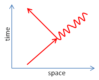

In a metal, can one electron decay into one lower-energy electron plus one phonon? (i.e., can the attached Feynman diagram occur?)
If we replace phonons by photons and consider the process in a vacuum, I guess this is prohibited because you can always boost to a frame where the incoming and outgoing electron velocities are the same. Thus, the electron has no ability to transfer energy to the photon because there are no photons with finite q but zero energy.
However, in a metal, Galilean and Lorentz invariance are broken by the crystal lattice, so it seems to me that the process ought to be allowed. Is my thinking here correct?

That is not, strictly speaking, a decay.
It corresponds to an electron losing energy - presumably it gained energy someplace.
I'd consider the diagram incomplete.

How is this different than the typical electron-phonon interaction?
For example, a transition in an indirect band-gap semiconductor would require both energy and momentum change, the latter being an interaction with phonons. The electron-electron bound state in Cooper pairing for conventional superconductors requires electron-phonon coupling (your Feynman diagram is one-half of the Feynman diagram for Cooper pairing).
Now, whether one can call this as a "decay", that's a different matter and, to me, seems rather odd.
Zz.

Can you elaborate on what you mean when you say that the Feynman diagram is incomplete?
Nomenclature aside, what I am trying to ask is, in a metal or semiconductor, can one electron in a state at energy [itex]\omega[/itex] spontaneously scatter into one electron at a lower energy state [itex]\omega-\Omega[/itex], plus one phonon at energy [itex]\Omega[/itex].
If not, then the deeper question is, what are the lowest order Feynman diagrams that can explain the fact that the electrons in any real metal have a finite lifetime?

Thanks, and yes, the typical electron-phonon interaction is exactly what I am trying to describe. I am interested to know if Feynman diagrams would be an appropriate way to describe the electron-phonon interaction in a "cartoon" fashion. If so, what do the lowest-order diagrams look like?

As ZapperZ said, this is precisely what the electron-phonon coupling diagrams look like:
https://www.google.com/search?tbm=isch&q=electron+phonon+diagram
Feynman diagrams are indeed an appropriate way to describe this interaction (in a very rigorous way!), see e.g. Mahan's Many Particle Physics book.
Great! I am declaring my original post to be entirely correct. Thanks for everyone’s comments.

This statement that the diagram is incomplete is not right, as far as I can tell. It would only be accurate for the example with electrons and photons in a vacuum, and the reason is that the diagram I drew would violate simultaneous energy and momentum conservation. The situation is different for the electron-phonon interaction in a crystal or semiconductor.
