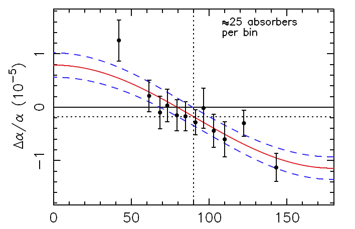

In the past, I came across the paper by Webb et al., "Indications of a spatial variation of the fine structure constant", published in Phys. Rev. Lett., 107, 191101, 2011, that seems to report the observation of a spatial variation of the fine structure constant, using the Keck observatory in Hawaii and the Very Large Telescope in Chili. The variation seems to fit a dipole distribution in the sky.
However, the paper is from 2011, and I did not follow their research. Hence, I do not know whether their result in the mean time has been confirmed by other research groups or not.

I'm going to disagree. The word they used was "indications" and not a stronger word like "evidence" or "observation". They had to publish what they saw, but what they saw is not particularly convincing,
Let's look at Webb's data:
First fact - the whole effect is driven by two points. Remove the first and last points and nobody would say there is any evidence of anything.
Point ordering is determined relative to the best fit dipole. The fact that the two most extreme points are at the opposite ends of the plot is, at least partially, how they are defined.
Second fact - the scale is about the same as the systematic error of the individual measurements, 10-5. So this is right at the edge of detectability. Some would say past it.
Third fact - this curve does not go through the origin, as it must by construction. The so-called monopole term [itex]m[/itex], discussed in [6] suggests they have a measurement systematic of order [itex]m\sqrt{N}[/itex] or about 0.7 x 10-5, more or less in agreement with my prior argument
Fourth fact = the "4.2σ" signal is the degree the best fit differs from zero. It is not (nor can it easily be converted to) a P-value. They pick the most significant dipole fit and quote how different the amplitude is from zero. That is a perfectly good number, but is not a P-value, nor is it even distributed normally with mean zero.
A very, very rough estimate of mine is that with no effect you would see an average maximum deviation from zero of 3.3σ and 4.2σ or more 12% of the time. This is not a proper statistical analysis, just intended to show whether it was one in 8 or one in 8 million.
Webb (who I only met once) is a smart guy and Flambaum (co-author, who I have interacted with several times) is a very smart guy. They know this. And that's surely why the title is what it is and they are not packing for a trip to Stockholm any time soon.
