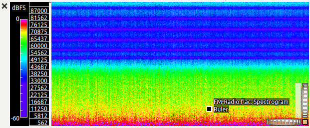

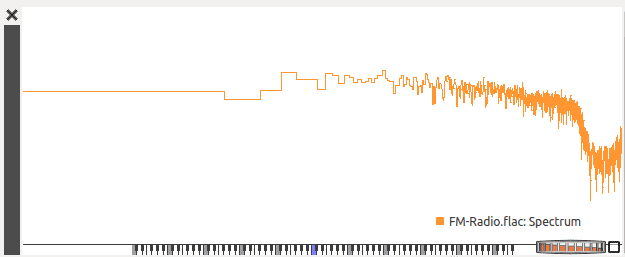

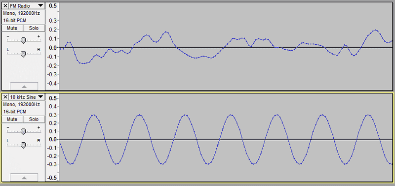

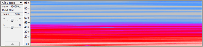

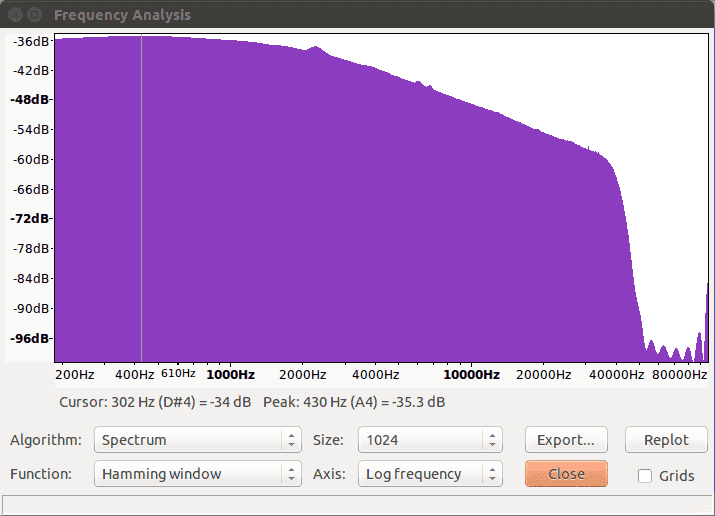

I've recorded the output hiss from a small battery powered radio operating inside a metal tin. From related posts, I can say that the radio is effectively shielded from receiving any FM transmission, and the resultant hiss is thermal noise in the early stages of the receiver.
I believe that the radio can output frequencies up to 50 kHz via it's earphone socket. Can this be correct?
My findings suggest that it can. When not constrained by handling FM audio, the input to the early receiver stages is thermal noise which (unconstrained) has an almost infinite bandwidth. The only constraint operating on it then comes from the radio's internal electronics. These will have spare capacity well above the audio range so as not to clip FM audio.
I've attached screen grabs from Audacity. This is the recorded hiss, and visually compared to a basic 10 kHz sine wave you can deduce how the hiss might reach 50 kHz, albeit at lower amplitudes.
I've also uploaded a spectrum analysis, and a spectrogram. These suggest Pink noise.
And finally, I've uploaded a zipped FLAC file of 5 seconds of the hiss should anyone have a real spectrum analyser. This would help greatly :kiss:
Is there any reason to think that a pocket radio can't have electronics capable of handling frequencies up to 50 kHz..?

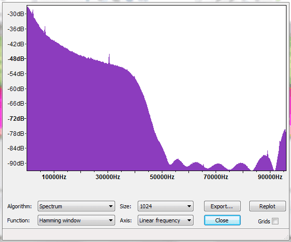

The purple spectrum shows three spurs at 30kHz or below. The presence of those spurs above the noise floor demonstrates that it is not white noise.
The -3dB point for the spectrum is at about 5kHz. That is the bandwidth of the audio output stage.
At 50kHz, the noise is about 55dB below the audio. That is about 0.25% of the audio band and so will be swamped by the audio and the spurs.

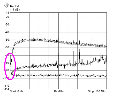

Why would you want to use a radio when the circuit I referred to in the other thread can give you this?
Bottom: noise floor of the measurement system
Next: noise floor with amp on and noise diode off
Top: Noise at 10mA and 60mA of current in the noise diode respectively.

I don't recognise these numbers from my spectrum. Doesn't it show signal ranging zero to approximately 40 - 50 kHz? Let's not use the term audio as it's >> 20 kHz.
There's a real risk that I've miss-understood the signal analysis as I'm new to it. I uploaded a .FLAC clip of the signal with my initial post. If you have the resources to analyse the spectrum yourself, I'd greatly appreciate comments.
40 dB down (~ -80 on the graph) means you have 100 times less voltage at that frequency than at the peak. dB = 20 log V1/V2
Normal frequency response corners are at -3db (half power). -33dB to -36dB is -3dB.
You have no idea what is causing the frequency slope, nor the spurs.
You are definitely building a toy. Period.

@ Paul Uszak, your purple spectrum.png in post #1 is plotted with a linear frequency axis. You have the technology, please plot it again with a logarithmic frequency axis from 10Hz to 100kHz, it will then be easier to see the structure of the low frequency part of the output. While you are at it, move the zero dB reference level so that the highest amplitude part of the band is at zero dB. It will then be easier to interpret the spectrum and why it has the shape that it has.
This is the best I can do. I can either have a log scale and no 0 dB, or 0dB with no axes!
The FLAC file of the actual noise signal I used is attached in the first post if you have access to better resources...
Perhaps this helps a little, it's got a combination of both ...

Attached is spectrum with a new vertical axis with zero RL.
Notice that the -3dB point is actually close to 2kHz.
That could give you about 1k bits per second.
Notice that the -3dB point i...
How did you get the 0dB? I couldn't figure it out.
However, since you've annotated the graph with volts, shouldn't we be discussing the -6dB point rather than the 3? Surely with the sound card's input being relatively high impedance compared to the headphone socket's output, we should be looking at amplitude and not power?
The highest point on the graph is defined as 0dB. That point is at about 400Hz where there appears to be a marker.
You are new to this game. -3dB is the half power point. Power is power = energy flow rate. Voltage and current are impedance dependent.
-20dB is one tenth of the voltage and therefore also one tenth of the current in the impedance used, so -20dB is one hundredth of the power.

Yes, 50kHz is there. It is at one 10,000'th the amplitude of the voice components near 400Hz.
It is your ability to understand the significance of the difference between -3dB and -80dB that is missing.
