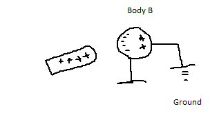

Mister T said:
You would need a nuclear reaction of much much higher energy to get a proton to come out of a body.
Please see the attached image. Here what would happen to positive charge and why ? Positive charge would move to ground or electrons would move from ground to Body B ?

fresh_42 said:
We live in a radioactive environment, which means that we receive and emit ##\alpha## radiation. Otherwise we only lose protons if we cut our nails or go to the hairdresser. Protons are strongly bounded in the nuclei and cannot "get lost", except for radiation, and if they do, it is called radiation.
What would happen if two metallic bodies (A and B) are touching each other, and a positively charged body C is brought closer to Body A.
C A<->B
I read in textbook that protons (positive charge) move from both A&B to extreme right of B, and all electrons from both A&B accumulate near C. So, basically here protons left body A and get into body B.

It seems you are right, as by looking at the figure in my textbook I got the feeling that protons moved from body A through body B. I am attaching the exact same figure.
After reading your answer, now my thinking is +ve charge accumulation in B is because of replusion from body A, and there is no +ve charge transfer from A to B.
Likes davenn
Yes, but don't use the accumulate (accumulation) at that infers that the + charges are moving.
Rather there is now an excessive + charge in an area because the - charges ( the electrons) are
driven off/forced away/repelled from that area by the presence of a negatively charged object.
