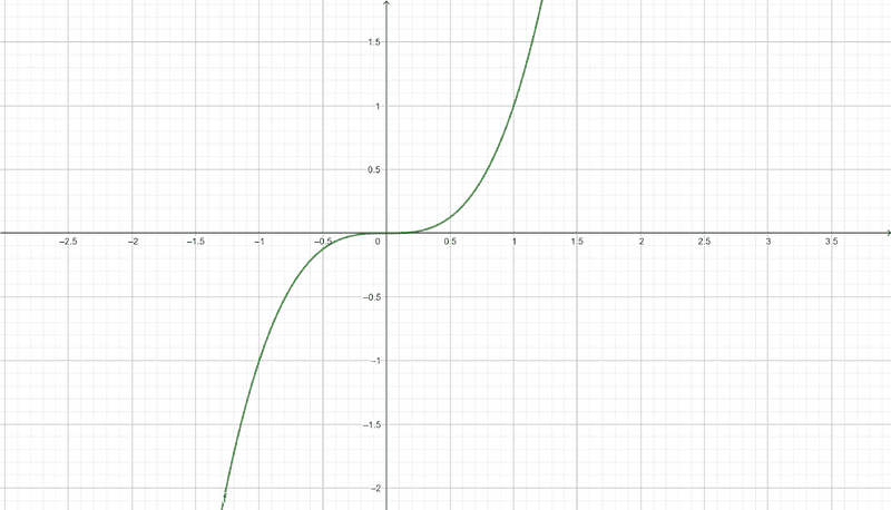

Hi, @hongseok, note that, for example, the unbounded function ##y=x^3## is Riemann integrable, since the definition holds for some closed interval ##[a,b]##; but at the same time I can argue it is an improper integral: unboudedness is the reason.
Best whises!
