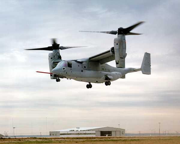

I was discussing this with my friend and he pointed out that with something like an osprey the lift force is well above the centre of gravity:
Which I think would be a big contributing factor to stability. Serenity's centre of mass is tricky to figure out without having a proper schematic, but it's safe to say the centre of gravity is much closer to the level of the lifting force. Also, with the osprey the lift force generated by the propellers is at the end of the engine nacelles. With jets where do you place the lift force?
Lateral axis stability would seem to be fine. To me it looks like the mass of the bridge and other stuff up front would be balanced by the huge rear end. Something else I see being an issue is that pretty much all your control would be derived from thrust vectoring. What do you guys think?
The Osprey has a lot of computers on board. This is how it can fly at all. Each of the propellers have cyclic control, like a helicopter. A sensor suite detects motions of the aircraft and then corrects that motion with adjustments to the propellers. The fact that it has pendulum stability (the center of mass is lower then the propellers) helps, but that does not provide stability of the aircraft. Despite all the technology in the osprey, it doesn't fly well and crashes a lot.
Applying this to Serenity, The lift comes from the bottom of the turbines, but it is where the nacels are attached to the ship that counts. Imagine a see-saw, the legs are down low, but the "lift" is where the axle attaches to the board.
To make an RC Serenity, you would need a pretty high tech flight stabilization system. Good luck
