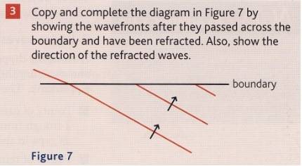

Can someone check my answers to these four wave questions

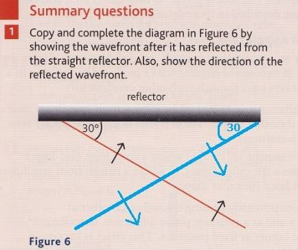

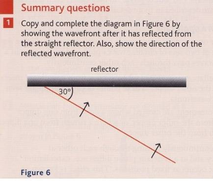

Question 1:
my answer:

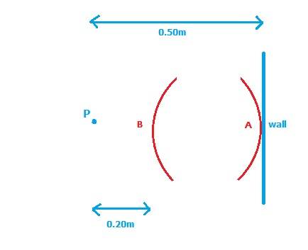

Question 2:
my answer:
part A and B of the question are shown by wavefronts A and B in the picture below,
Question 3:
my answer:

Looks good over all. Some specific comments:
2. I would say you are correct for a rough sketch. A more accurate drawing would show different amounts of curvature for the two waves -- probably not required for full credit/marks here, but that is ultimately up to your instructor.
3. No, the gaps would not be bigger than they are in the incident wave. Think about it: if the refracted wave were in the exact same direction as the incident wave, how would the wavefront gaps compare to those in the incident wave? (I.e., would they be larger, smaller, or the same?)
can I ask what you mean by that? haven't I done that in the diagram? :confused:

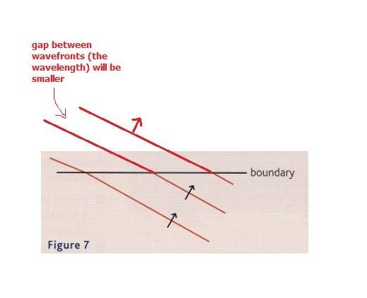

So for question 3, have I drawn it correctly then? (the gaps would be smaller for the refracted waves)

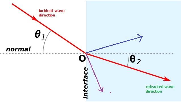

You know, I think my query was phrased awkwardly, here's what I want to ask with a diagram to help:
if the refracted direction is the purple arrow (so that wave direction would be further away from the normal than the incident direction), then would the wavefront gaps be bigger?
and also, is it possible for the incident wave to be refracted to the direction of the blue arrow? If it is, how would the gaps between the refracted wavefronts differ from the gaps in the incident waves?
In the diagram, the two waves seem to have the same amount of curvature. Probably okay, since they just ask for a sketch, but in reality wave B would be less curved than wave A, having traveled for a longer time.
Yes, sorry I did not clarify that. You did draw it correctly.
Yes.
Nope, it's not possible. The angle θ2 in your figure must be between 0 and 90O; it can't become negative and result in the blue ray.
