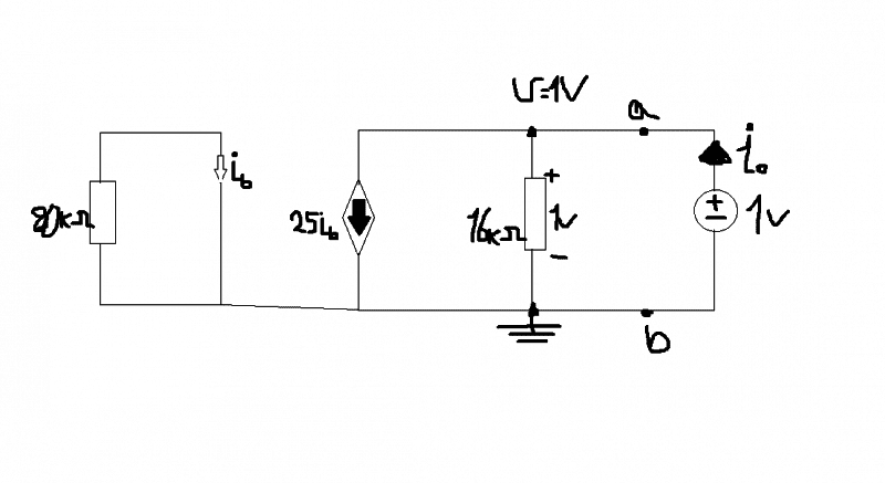

Can someone explain why the voltage here is zero?
In summary, the voltage over the 80k resistor is 0, but it doesn't make sense because there is no current through it. Can someone explain why there is no current through it?

I have the circuit in the picture below, and using KCL and KVL I found that the voltage over the 80k resistor is 0. However, I don't understand why this is correct. Can someone explain why there is no current through it?

I used the node voltage method to get 25ib + 1/(16k)-i0 = 0. After that I used KVL through the 80k resistor, 16k resistor and 1V source, which gave me 80k * ib - 1 + 1 = 0. So ib = 0.

Imagine you took a resistor and wired its leads together. Why would there be any current flowing in it?
I guess you mean you used KVL for the two loops and "added" the equations together. There's no loop that takes you through each of those components.
You could have stopped at 80k*ib = 0.

Thanks for the reply. Could you also tell if the energy in a capacitor at time t equals half of its capacitance times its voltage at time t? So w(t) = 1/2 * C * v(t) ?

Sorry, I forgot to square the voltage. But is this correct then: w(t) = 1/2 * C * [v(t)] ^2 ? I couldn't understand the wikipedia article. You see, I used this formula, but it doesn't give me the right answer

Answer for what? There's no capacitor in your schematic.

EDIT: Ok, sorry again, but I just found out what I did wrong: When taking the square root, I forgot that there would be two answers. The negative one turned out to be the correct one. Thanks for helping me out figure out my original problem!
Sorry, the original post was just part of the problem.
I used that schematic to find Rth = 16k ohms and Vth = -19.8 V. I used this to make an RC circuit (C = 0.25 * 10^-6 F), which I solved to find that the capacitor's voltage is given by v(t) = [ 19.8 * (e^(-250t) - 1) ]. Everything up until this point was correct according to the solutions manual. The final question was to find how long it takes for the energy stored in the capacitor to reach 36 % of its final value. This is where I set up the equation w(t) = 0.36 * w(infinity). But for some reason this doesn't give me the correct answer. I used the following values:
