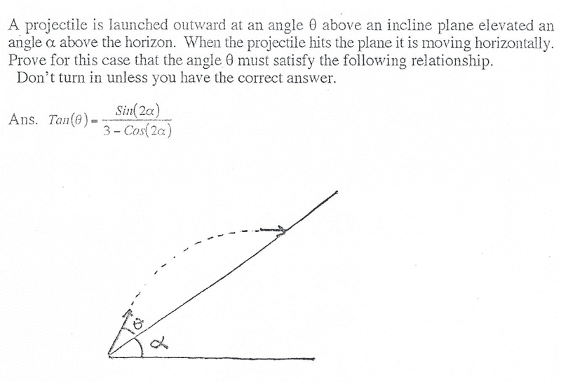

I am sorry, I generally would show some work but I have no clue on how to start off to find angle theta. The answer is given below and I have to get it. I don't know at all how to approach this problem and unfortunately I am not too strong on my trig identities either but I will try. May some please give me some hints?
Forget the complicated answer. Isn't moving horizontally a big clue?

Oh okay so Vfy = 0 and Vfx = Vfcos(0°) = Vf. Let me think about this some more, thank you.
You need an equation relating θ and α. Since the ball is at maximum height, horizontal distance traveled is R/2. Do you know the relation between R, H and angle of projection(which is (θ+α) here)?

That is not true. Vx is constant throughout and is equal to Vfcos(θ+α).
You need the relation between θ and α.

I must admit I would never have thought of calculating R. The way I looked at it was that the point where it lands is ##(x, y)##. I can calculate this from normal projectile motion (it's the top of the trajectory). And I know how this point relates to ##\alpha##.
Perhaps this isn't the quickest way, but I ignored the answer and got:
##tan(\theta) = \frac{tan(\alpha)}{1+2tan^2(\alpha)}##
You could shoot for this if you like. Then, use a bit of trig manipulation to get the answer you need.
It looks better than to me than the answer given, not least because it is equivalent to:
##tan(\alpha + \theta) = 2tan(\alpha)## (Which I find the most pleasing answer!)

Here's another way of doing it.
Horizontal displacement is x=R/2 and vertical displacement is H (R is for range and H is for maximum height).
If you take ratio of the expressions of R and H, you'll see
Rtan(Φ)=4H(a standard result!), where Φ is the angle of projection. In your problem, Φ=θ+α.
So,
Rtan(θ+α)=4H
Hence, xtan(θ+α)=2H where x=R/2.
tan(θ+α)=2H/x.
You can write the ratio H/x in terms of angle α(simple trigonometry) and do some trigonometric manipulations to get the final answer.
