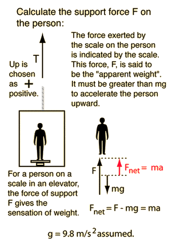

2) A 86.0 kg person stands on a scale in an elevator. What is the apparent weight in each of the following situations?
(a) when the elevator is accelerating upward with an acceleration of 1.10 m/s2
(b) when the elevator is moving upward at a constant speed
(c) when the elevator is accelerating downward with an acceleration of 1.20 m/s2

2.Elevator Problem
This is an application of Newton's second law to the forces felt in an elevator. If you are accelerating upward you feel heavier, and if you are accelerating downward you feel lighter. If the elevator cable broke, you would feel weightless since both you and the elevator would be accelerating downward at the same rate.
support force F = mass x acceleration + weight
For a mass m= kg, the elevator must support its weight = mg =Newtons to hold it up at rest. If the acceleration is a=m/s² then a net force=Newtons is required to accelerate the mass. This requires a support force of F=Newtons. Note that the support force is equal to the weight only if the acceleration is zero, and that if the acceleration is negative (downward), the support force is less than the weight. If you enter a downward acceleration greater than 9.8 m/s² you will get a negative support force, showing that you must force it downward to get an acceleration greater than that of free fall.

ok so i understand in order to get the normal force u have to include gravity=9.8...
for question 2) would i use ∑F=ma...but i don't understand the part about constant speed?
And for number 3...i start by adding 90 degree + 12 degrees= 102, then 180-102=78 then i got lost when it asked for the ratio.
yes
If the speed is constant, what is the acceleration?
