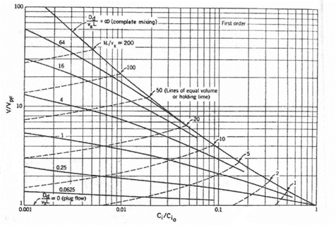

Can someone identify what this graph is used for?

Hi, I was asked by my senior to find out what this graph is and how to use it. No details were given as to where they found it.
I know already that this is used to compare CSTRs and PFRs performance for first order reactions, but I can't deduce what the expressions Dd/(vxL) and kL/vx are for and what the variables represent.
Thanks a lot!
jedishrfu said:
In general, these kinds of graphs are called nomograms or nomographs:
https://en.wikipedia.org/wiki/Nomogram
They were popular before the advent of personal computers and calculators.
What this particular one is, I'm not sure but I found this website with a similar chart:
http://slideplayer.com/slide/10044354/
Hey, thanks for the response!
Yeah, I'm familiar with nomographs. I just can't determine what the variables in the graph represent.
But thanks a lot for this information! I really appreciate it!
This graph is for a tubular chemical reactor in which there is axial mixing/dispersion. The velocity profile is assumed to be flat. The reaction is assumed to be first order decay. The dimensionless group ##D_d/v_xL## is a measure of the axial dispersion, and is the inverse of the Peclet number. The dimensionless group ##kL/v_x## is the ratio of the residence time in the tube to the characteristic decay time for the reaction.
##D_d## = axial dispersion coefficient
##v_x## = axial velocity
L = length of tube
k = first order reaction rate constant
