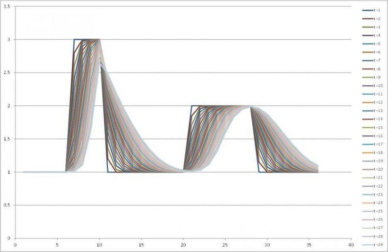

I had fun doing this in Excel
36 sections ##\rho(x,0) = 1## except 7-10: 3 and 21-28: 2 . ##v_{\rm \;max} = 0.3, \ \ \rho_{\rm \;max} = 6## .
I noticed that a block of 5 cars/section doesn't move when in between 1 car/section ( ##1-{1\over 6} = 5-{25\over 6}## ), so there are some limitations to your expression (or I took the steps too big...:smile: )
But otherwise you see the 3 cars/section block progress slower than the 2 cars/section , which is nice.
36 sections ρ(x,0)=1\rho(x,0) = 1 except 7-10: 3 and 21-28: 2 . vmax=0.3, ρmax=6v_{\rm \;max} = 0.3, \ \ \rho_{\rm \;max} = 6 .
I noticed that a block of 5 cars/section doesn't move when in between 1 car/section ( 1−16=5−2561-{1\over 6} = 5-{25\over 6} ), so there are some limitations to your expression (or I took the steps too big...:smile: )
Thanks a bunch for your help, @BvU, I can't believe you did all that in Excel! I'm sorry if this is obvious, but I'm still not quite wrapping my head around what's going on in that graph. I can see the sections on the x-axis, and the density on the y-axis, but I'm not quite following where those curves come from. Could you possibly show me the input for that graph in Excel?
Sure. There's three blocks. Columns are time, rows are distance.
First block: ##\rho(x,t)##
Second: ##\rho\, v = \rho \,v_{\rm max} (1-{\rho \over \rho_{\rm max} } )##
Third: ##\Delta (\rho\, v) \qquad ## (I use ##\Delta x = 1 ##)​
Values in column i of the third block give the change from column i to i + 1 in the first block.

initial density: pretty random choice.
different numbers: then you want to take smaller time steps. So instead of delta t = 1 as I did, you take delta t = 0.01 or something.
An easy way to calculate numerically is
[tex]
\frac{\Delta\rho}{ \Delta t } = - \frac{\Delta v_{max}(\rho - \frac{\rho^2}{\rho_{max}})}{\Delta x}
[/tex]
So, if you know all the values at a time t, and because [itex]\Delta\rho = \rho_{t+1} - \rho_{t}[/itex], then you can calculate [itex]\rho_{t+1} [/itex] this way:[tex]
\rho_{t+1} = \rho_{t} - { \Delta t } * \frac{v_{max}(\rho_t - \frac{\rho_t^2}{\rho_{max}})}{\Delta x}
[/tex]
But any numerical solutions will only work if you use a [itex]\Delta t [/itex] restricted to
[itex]v_{max}(\rho_t - \frac{\rho_t^2}{\rho_{max}})< \frac {\Delta x}{\Delta t} [/itex]
In other words, if you "speed" crosses your grid on a single time step, then numerical errors will grow exponentially, and your calculation will be ruined. So, if your [itex]\Delta x [/itex] is constant, you need to check that [itex]\Delta t [/itex] is small enough on each timestep.
