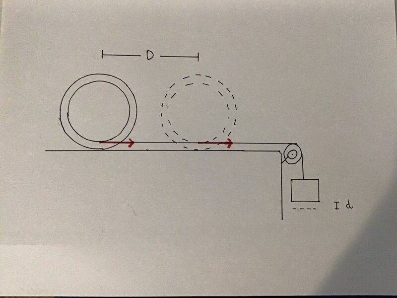

Here I drew the the system. The cylinder moved a distance D at a later time. The force (in red) moves the object for a distance D. The weight on the right also displaced a smaller distance d.
work done by the weight = mgd
work done on the cylinder = mgD

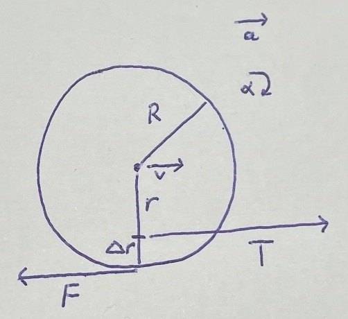

So this problem is straightforward to work out, though a little tedious. Here is a free-body diagram for the wheel:
We have the radius of the wheel ##R## and the radius of the axle ##r## with ##R=r+\Delta r##. ##a## and ##v## are the acceleration and velocity of the center of mass, and ##\alpha## is the torque about the center of mass. The wheel (including the axle) has a mass ##m## and a moment of inertia ##I=kmR^2## where ##k## is some number that depends on the exact geometry of the wheel and axle assembly.
We are only interested in horizontal forces so there is the tension ##T## provided by the string and the friction force ##F## from the ground. The wheel rolls without slipping so ##a=R\alpha##. From Newton's 2nd law and Newton's 2nd law for rotation we have $$T-F = ma$$ $$FR-Tr=kmR^2 \alpha$$ Solving we get $$a=\frac{T \Delta r}{m R (1+k)}$$ $$\alpha=\frac{a}{R}$$
The rate of work is given by the power which is the force times the velocity of the material at the point of application of the force. The velocity of the material of the wheel goes from ##0## at the ground to ##v## at the center, so at the point of application of ##T## the velocity is $$v_T=\frac{\Delta r}{R} v$$ so the rate of work done on the wheel by the string is ##T\cdot v_T=T \frac{\Delta r}{R} v##.
Now on the other end of the string, assuming that the string is ideal (flexible, massless, inextensible), the external force is applying tension ##T##. If the string is a length ##L## then the position of the end of the string ##x_S## is equal to the position of the center of the wheel ##x## plus ##L## and minus the amount of thread that has been wound up onto the spool ##r\theta##. So that is ##x_S=x+L-r\theta##. Now, since we know ##a## and ##\alpha## from above we can solve $$x=\frac{a}{2}t^2$$ $$v=at$$ $$\theta = \frac{\alpha}{2}t^2$$ $$\omega = \alpha t$$ and with those we can obtain $$x_S=x-r \theta + L$$ $$x_S=\frac{a}{2}t^2-r\frac{\alpha}{2}t^2 + L$$ $$v_S=at-r\alpha t =\frac{R a}{R}t-\frac{ra}{R} t $$ $$v_S=\frac{\Delta r}{R}at=\frac{\Delta r}{R}v = v_T$$
So the rate of work done on the string by the external force supplying the tension is also ##T\cdot v_T=T \frac{\Delta r}{R} v## and hence energy is conserved at all points in time.
No, it is not, see above. As I explained in post 9 it is the motion of the material at the point of application of the force that is the relevant quantity. Not the motion of the point of application of the force.
work done on the cylinder = mgDView attachment 294549
leafy said:
Let's say I was pulling the string. I felt a tiny displacement. So my work done is the force I pull times the displacement my hand made. On the cylinder end, the same force carry by the string, but the displacement is many times higher. The work done is then force time big displacement. Obviously, the energy doesn't add up.
Using your well drawn diagram, it seems to me that combining D and mg is not correct.
The force doing effective work should be the one applied to the center of mass of the cylinder, which is the effective distance represented by D.
The magnitude of that force is smaller than mg, as many times as the distance of each force to the contact point with the table is different.
If you replace the cylinder with a lever pivoted at the table, you could visualize that you are losing force intensity at D, as you have less and less mechanical advantage as you apply resistance to mg higher and higher.
