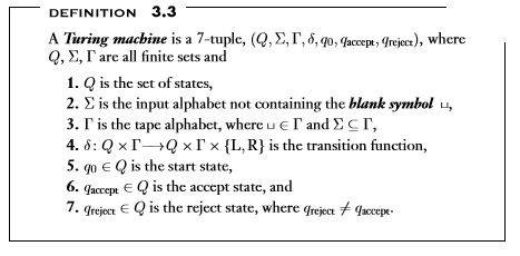

Ah I see... Given the definition of a Turing machine:
and given a code $n$ , a Turing machine can determine whether the above properties are satisfied by $T_n$ or not. Right?
I am not sure what exactly you mean by "the above properties are satisfied by $T_n$". The photo lists a definition and not properties. Further, $T_n$ is a function that takes an input string and maps it to the output of the machine with code $n$ on that input. I am not sure how the definition of a Turing machine can be satisfied by this function.
Turing machines are written a finite strings. In particular, the transition function $\delta$ is written as a sequence of 5-tuples. As a result, a TM is written as a string with a clear structure (it's a 7-tuple where the 4th element is a sequence of 5-tuples and so on). It is possible to verify on any universal computer whether a given string has this structure.
I understand... Thank you very much for your help! (Smile)
