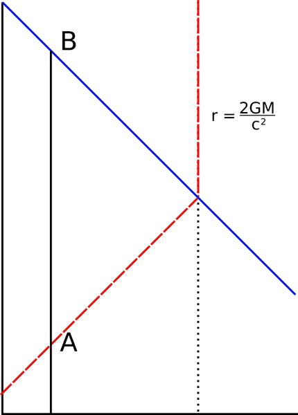

One of the things that helped me understand a horizon best is an example of a spherically symmetric "shell" of light rays all converging on a single point.
I couldn't find exactly what I was looking for, so I made this based off of what I remember and reason;
It's a spacetime diagram with increasing height representing later moments in time, and increasing distance to the right representing increased radial distance "r" from the center of a spherical coordinate system.
The blue line slanted towards the left at 45* represents a spherical shell of infalling light rays, with r = 2GM/c2 being its associated Schwarzschild radius. The red dashed line is the event horizon of the black hole that will form by the convergence of the "blue" light rays.
The black vertical line along points A and B is the worldline of some unfortunate free-falling observer. Now, I hope I'm not misleading here - I'm actually not entirely sure what happens after A along this line, but I presume that because this observer remains outside the light-cone of the infalling light rays, they are unaffected by the light rays, and thus aren't even aware that they're in an event horizon - not seeing the incoming light rays or feeling any gravitational influence at all. Any time before B, this region of space inside an event horizon is impossible to differentiate from the region of space outside of one, as it rests outside the light-cone of the infalling light. Only when impacted by the incoming light at B does the observer get any indication whatsoever of being inside an E.H.
In fact, he "falls through" the E.H. at A, since A is inside a trapped surface - nothing, not even a ray or light emitted outwards, can now escape from the singularity that hasn't even formed yet. In fact, there's not even a "black hole" yet (the light has not yet come within its Schwarzschild radius at time A), but there's an E.H.
If this observer let's out a light ray at time A, then it will arrive at the Schwarzschild radius at the exact moment the infalling light forms a black hole, trapping the light ray at r = 2GM/c2.
I could be wrong about the observer's worldline at T = c, though, where c is the point in this coordinate time where the infalling light passes r = 2GM/c2 - perhaps the curved spacetime makes my "outside the light's light-cone" reasoning fall apart here, but I don't think so? I hope/think Peter will correct me if I'm wrong, here.
In any case, the important takeaway is that this horizon forms before the black hole does - before the light has converged within r = 2GM/c2. The observer is trapped at A, despite the light rays not having even converged within the Schwarzschild radius yet. This really helped me understand that an event horizon isn't a sort of thing you can touch - it's just as real and physical as anything you can touch, but what it is is a set of coordinates that defines a region of spacetime that light cannot escape from. It's physical, but it's made entirely of spacetime geometry and a set of points in space, not any sort of solid or fluid structure or anything.
You have it correct. Since the only stress-energy present is the infalling shell of light rays, spacetime inside the shell is flat (by the shell theorem). So the free-falling observer will sit happily at rest, not falling inward at all, as long as he is inside the shell.
Yes, exactly.
No, it isn't. There is no trapped surface anywhere in this spacetime until the point at which the shell crosses the horizon.
How do we know that A is not inside a trapped surface? Remember the definition of a trapped surface: radially outgoing light stays at the same radius. But the red dotted line through A is radially outgoing light--and it's not staying at the same radius, it's moving outward. (In fact it's moving outward in a flat region of spacetime, as noted above.) So there is no trapped surface at A--and in fact there can't be one anywhere in the flat region, i.e., inside the infalling shell.
Yes, this is true. But it doesn't mean what you are thinking it does. See below.
He is in the sense of being below the horizon, but he is not in the sense of not being able to move outward. Nothing stops him from firing rockets and moving outward from A. He won't be able to catch up with the outgoing light ray through A, but he can still move outward. He can move outward and still be inside the horizon because the horizon itself is moving outward at A--the outgoing light ray through A shown by the red dotted line is the horizon, and it's moving outward.
The key thing you have left out of your analysis is: what happens when the free-falling observer passes the shell? You have shown what happens to the outgoing light ray that passes through A: it becomes trapped at ##r = 2M## and stays there forever. But note that that means the light ray is outside the shell. A timelike observer can similarly pass through the shell, although he won't be able to keep up with an outgoing light ray. So the free-falling observer will be able to pass through the shell; but after that point he will be forced to fall inward towards the singularity. (An outgoing light ray would also be forced to fall inward at that point, since it is well inside the horizon; but it would do so more slowly than the free-falling observer.)
