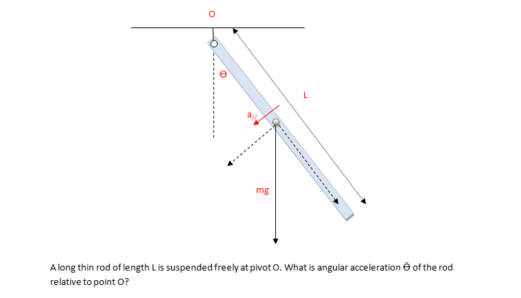

Summary: When I tried to find the angular frequency of a rod pendulum, I attempted to find its angular acceleration first, however, I realized that the results are different by using different approaches. i.e. (1) Newton's second law for a system of particles (2) Newton's second law for rotation.
The two approaches should give the same angular acceleration.
can anyone check if any mistakes in my first approach? Much appreciated!
Approach 1
Take the whole rod as a system, so we can apply Newton's Second Law for a system of particles.
The Newton's Second Law for a system of particles states that the total net force equals the mass of the rod multiplies the acceleration of the center of mass (or CG here), which is located at the center of the rod.
As the CG moves along a circular path, we can resolve the acceleration of the CG into the radial component and the tangential component a//.
As we are just interested in the angular accelerated, we just consider the tangential motion.
a// = (L/2)Ӫ (1)
where Ӫ is the angular acceleration of the rod
Then we can also resolve the gravity in the radial component and tangential component (-mg *sinϴ). By using Newton's second law for a system of particles, the tangential acceleration is determined solely by the tangential component of the gravity, which means
-mg*(sinϴ) = m*a// (2)
(the radial acceleration is determined by the Reaction force from the pivot and the radial component of the gravity, however, the radial acceleration does not affect the angular acceleration, so we could ignore it here.)
(1) and (2) give:
Ӫ = -(2/L)g* sinϴ (*)
Approach 2
By using Newton's second law for rotation, we can easily apply the following relationship
τ = I Ӫ (3)
, where τ is the torque about point O and I is the moment of inertia, which equals 1/3 m L^2 .
The net torque is just the torque of the gravity, τ = -L/2*mg* sinϴ (4)
Linking (3) and (4) , we have
Ӫ = -(3/2L) g* sinϴ (**)
Conclusion:
The angular acceleration from approach 1 and 2 are so different!
Questions
I am pretty sure that the (**) is correct while (*) is not, however, I couldn't find any problems in the working in approach 1 (which bothers me so much).
Please help to identify the mistake(s) I made in approach 1 ! much appreciated!

Approach (1) doesn't work. The pivot will have a force component that is not in radial direction. It is this force that causes the rod to rotate (as seen from the center of mass) - which is necessary for the pendulum motion.
What about the force at the pivot?
Thank you for your suggestion! Can you qualitatively prediction the variation of the reaction force on the pivot?

Hi, I just come up with another picky case which may disagree with what you mentioned about the force from the pivot.
suppose that there is a heavy bob pendulum linked with a massless rigid rod.
From Newton's second law for rotation (must be correct). I can find the angular acceleration as
Ӫ = - (g/L)* sinϴ (1)
From Newton's second law for a system of particles, and boldly assume that the pivot only provides a tangential force on the bob, similar to approach 1 in my original post. I can get
Ӫ = - (g/L)* sinϴ (2)
(1) and (2) are identical, which means for this case the pivot does not give any NON-tangential force on the rod?!
To sum up my doubts: For a heavy rod pendulum, pivot exerts a NON-tangential force on the rod; For an ideal pendulum with a massless rigid rod, the pivot only exerts a tangential force on the rod.
What cause the pivot to 'decide' the direction of reaction force on the rod?
That is correct. What is the moment of inertia for a point mass about the center of mass?
Likes mfb and Homgkung
I think I got what you mean! A non tangential force is not needed as the moment of inertia is zero. Thanks a lot!
