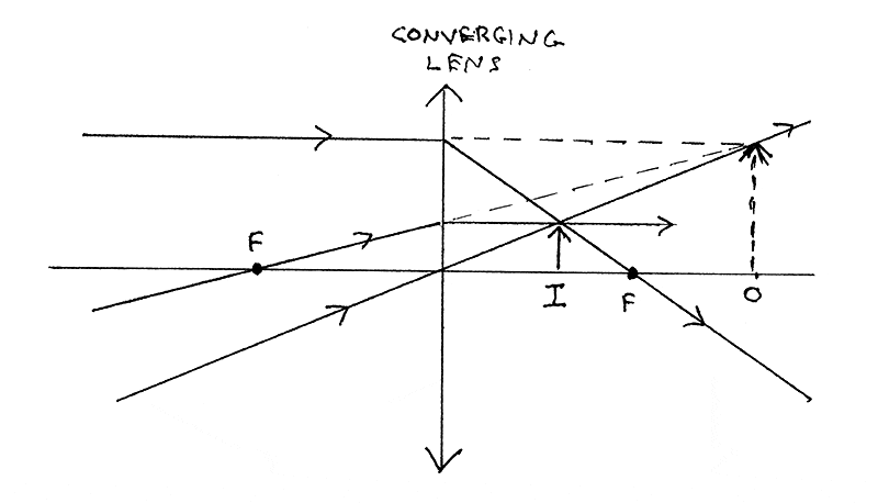

Here's an example. The incoming rays from the left converge towards a virtual object at the right of the lens, but never actually pass through it, except for the single ray through the center of the lens. After refraction, the outgoing rays converge towards a real image and actually pass through it.
