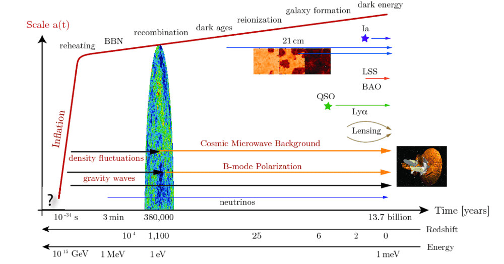

This article... http://inspirehep.net/record/827549/plots ...features the following diagram.
As you can see, the CMB is displayed as a kind of wall, albeit one that permits certain types of information to pass through it.
I read this diagram to mean that density fluctuations and gravitational waves can carry meaningful information to us about the inflationary epoch. Also, that primordial neutrinos can carry meaningful information to us about Big Bang Nucleosynthesis.

1. Could my reading of this diagram please be checked and confirmed/corrected? Thank you.

1. Your reading of diagram is correct
