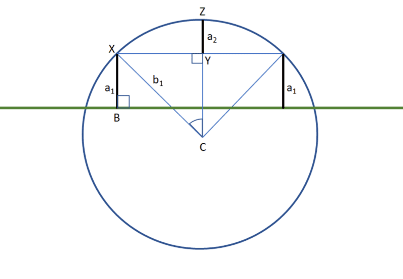

OK, see if this makes sense. In the image below, the green line is the horizon. The blue circle is the Sun's path above and below the horizon.
The altitude ascending and descending is a1 (also line BX). If we know the radius of the circle that the Sun follows, then we can calculate the angle XCY as half the time the sun took to cross between the two observed altitudes. Knowing the hypotenuse is the radius, that allows us to calculate the leg CY with good old SOHCAHTOA. That means we can subtract CY from the radius and get YZ. Add YZ to leg BX and you have the altitude of the sun.
There is probably a more elegant way, but that is what I doodled out. However, part of what would make this hard is knowing the radius in a unit that is comparable to the observed altitudes. Fiddling with Stellarium, I can see that the observed radius changes by day.

I worked it out on paper from Stellarium and it is a bit off - about 4 degrees. I am guessing the radius (in degrees) of the Sun's orbit and the visible arc angles are just not aligning. the problem, as I see it, is that the Sun moves in an apparent ellipse, so circular trig won't do it.
You should really learn spherical trigonometry to get this straight.
There is no perfect way of mapping a sphere on to a plane. There is one method, called stereographic projection, that maps circles on the sphere to circles in the plane. But it does not preserve distances, so you can't directly read off the quantities of interest.
Perhaps the best way for you to proceed, is to take the result from spherical trigonometry $$
\sin h = \sin \phi \sin \delta + \cos \phi \cos \delta \cos \tau
$$ for the altitude ## h ## and solve for the latitude ## \phi ##. For the hour angle ## \tau ## you need of course both observations: half of the time interval between the first and the second. (## \delta ## is the declination of the sun, which we assume known.)
