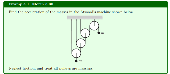

Can we solve this Morin's problem without conservation of string?
In summary,The solutions are,However, how would we solve this without using the idea of conservation of string? Can we apply Newtons second law to each mass?My working is:Then apply Newton's Second Law to each pulley,(Line 1)(Line 2)(Line 3)(Line 4)Many thanks!I don't think your setup is quite right. Just looking at your first equation, you've set the tensions upward equal to gravity downward. This equation says they're equal, and the mass shouldn't move. You need an equation

For this problem,
The solutions are,

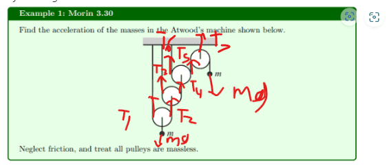

My working is:
(Line 1)
(Line 2)
(Line 3)
(Line 4)
Many thanks!

I don't think your setup is quite right. Just looking at your first equation, you've set the tensions upward equal to gravity downward. This equation says they're equal, and the mass shouldn't move. You need an equation that gives it freedom to move. It should probably have an ##a## in it somewhere.
I don't ever remember using conservation of string to solve Atwoods problems. I could be misremembering, though.

It seems to me that equation of line 4 is not correct.
T5, T6 and T7 must have the same value.
Can you visualize the system of pulleys as an instantaneous arrangement of levers?
If so, you could easily understand the relation of the external forces (mg left and mg right).

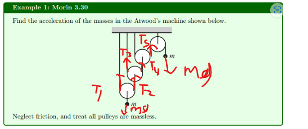

(Line 1 fixed?)
(Line 4 fixed?)
Are the lines fixed now @Lnewqban ?
Many thanks,
Callum

It seems that line 1 was correct as shown in post #1.
Without solving the whole problem, I would not know how correct lines 1 and 4 are as shown in post 7, sorry.

I think he's asking whether or not it's possible, meaning whether it's necessary to utilize that fact or not. I'm not sure that it is, now that I look at it more closely. Without actually solving it, I think you are going to end up with more unknowns than you have equations for.
As for equations 1 and 4, those look correct to me now, other than the fact that you have labeled your accelerations to be the same. You should give each mass it's own acceleration, or couple them together with another equation, probably involving the tensions.
I think the issue with trying to apply N2L here is that the pulleys are massless, they can't obey N2L, as any force would give rise to an infinite acceleration. You would need someway to work around the lack of mass, and effectively turn it into a kinematic equation, which I believe is one of the points of "conservation of string". Now you have equations dealing with distances (string lengths) as opposed to forces.
In general, if you have N variables, you should expect N equations to be able to get unique solutions, if they exist.

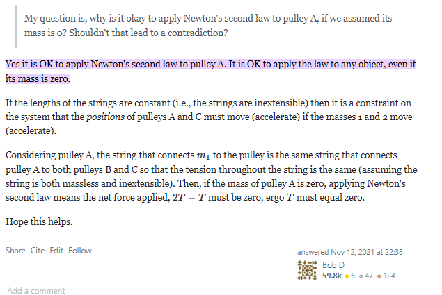

Thank you @BiGyElLoWhAt , that was what I was trying to ask! Also thank you @Vanadium 50 for the stuff you said on string constraint! Also why would massless pulleys not obey Newton II?
According to this Physics SE post, Newton II is obeyed by massless pulleys [well at least the way I read it! :) ]
https://physics.stackexchange.com/q...m#:~:text=Yes it is OK to,if its mass is zero.
