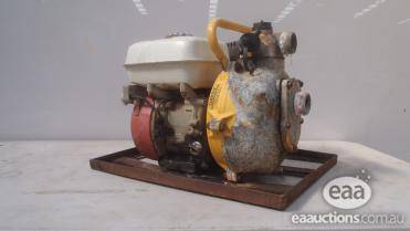

wanting to know if you could create a hydro system using an old firefighting pump discarding the old petrol or electric motor and replacing it with an generator or alternator. water would flow into the pump which would drive the generator
Welcome to the PF.
It sounds pretty inefficient. Can you post pictures and specs on the FF pump? What type of pump mechanism is it?
That looks like a centrifugal pump so I doubt you would be able to do anything with it.
what type of pump would you need?

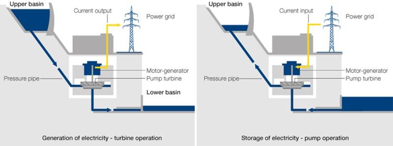

In some cases, say a pumped storage hydropower plant, I think the pump also works as the turbine.
Some, but not all pumps will work in reverse as turbines.
Some, but not all turbines will work in reverse as pumps.
An introduction to the term “turbine” is critical to learning about hydroelectric power generation.

That would depend largely on what type of fire pump you are looking at. Most modern fire pumps are a multistage device with sliding valves and auto pressure recirculation. This allows them to recirculate internally when there is no flow and increase the flow themselves as the requirements increase. They are also capable of delivery different pressures to separate outlets. Without defeating or bypassing these functions I do not think it would work as a prime mover.
If it is an older strictly single stage it should work relatively well.
Oops, followed the thread a little further and saw the picture. I agree that it is probably a centrifugal pump and would be very low efficiency if you could even get it to work.
If the design were right it might work but most likely only efficiently under a narrow range of operating conditions. Do you have a performance graph for the pump? Open her up and take pictures.
