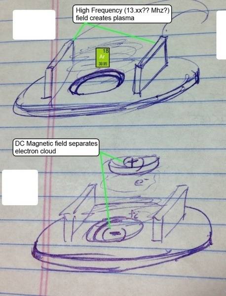

Hello everyone,
I want to create a plasma chamber, and so far, I have a vacuum bell.
I have a couple of questions... excuse if I have the terminology wrong.
I would like to create a plasma, and then apply a DC magnetic field, so the electron cloud "separates" somewhat from the gas.
I have many questions.
  1. What gas should I use? Argon?
  2. What could I use for the high frequency for creating the plasma? Regarding equipment... what is the name of this?
  3. What power supply could I use to generate the DC magnetic field, so the electrons are displaced to the side?
  4. Any books, or website links you can suggest?
There are many more questions... yet I can start with this.
I have a mechanical vacuum pump from air conditioning work, which I hope to use for the first vacuum stage.
For further vacuum, I am not sure if to go with an oil-diffusion trap (pump?), or a turbo-molecular pump.
Thank you all for your help!

Here is a sketch of what I was thinking.
Please let me know if I am way off base, or... if this is possible?
What do you guys think?
The magnetic field won't separate the ions and electrons unless they are also in motion. I think you are confusing magnetic field with electric field.
If you have access to a welding machine, the welding arc is basically a plasma.
Good feedback Khashishi and cronanster.
I do believe I am confusing a magnetic field with an electric field.
Can you think of any way where I could get some sort of "electron cloud" going, without interference (minimized) from the positive ions?
Maybe you can take a cathode ray tube out of an old TV screen.
ElectricPaint said:
Good feedback Khashishi and cronanster.Can you think of any way where I could get some sort of "electron cloud" going, without interference (minimized) from the positive ions?
ElectricPaint, you already know electrons are negatively charged, and that like charges repel. Whenever an electron feels the charge of a neighboring electron it tries to get away! So what you are proposing, an "electron cloud", would require a strong force field to constrain the electrons to stay near one another.
Note also, that the definition of a plasma is NOT the same as that of an "electron cloud". Plasmas normally have a mixture of both positives and negatives so the overall net charge is close to zero.
Inside a cathode ray tube (CRT) there is a stream of electrons moving from the hot emissive cathode towards the positively charged anode. Same as in a vacuum tube amplifier. In neither case is there a stable, fixed cloud of electrons.
Will you please be more specific and describe your planned project, along with your objective(s)? Then others here might be able to give some useful comments and suggestions.
