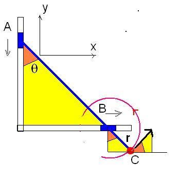

Can You Design a Mechanism that Translates Rotational Motion to Linear Motion?
In summary, the problem is that the windup toy only works in one direction. There is no mechanism that translates rotational motion to linear motion and then back to the original state.
pikachoo
Designing Mechanism -- Updated
Anyone got any idea on how to design a mechanism that…
◦Translates rotational motion (clockwise OR anti-clockwise) to linear motion
◦Linear motion ONLY to the right
◦Upon release, the mechanism returns to its initial state

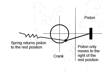

What I had in mind (see above) was this..
Rotating the crank in either direction causes the piston to move.
The piston only moves to the right of the rest position.
Upon releasing the crank the spring returns the crank and piston to the initial position.
Ok so rotation of the crank is limited to half a turn but you can fix that with gearing.
