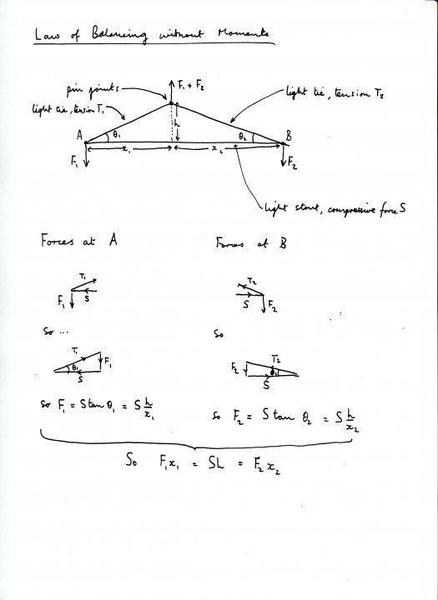

Try this treatment of balancing. It's not original, but I got to it when I pondered the problem: how does a weight on a see-saw know how far from the fulcrum the other weight is? My puzzlement was because I'd been thinking of the see-saw plank as thin and structureless. It isn't. The balancing can take place only because of the system of stresses in the plank. At first I replaced the plank by a pin-jointed lattice structure and calculated the tensions and compressions in the members laboriously, step-by-step. But this treatment did deliver the law of balancing, usually derived from the law of moments. Then someone pointed out to me that a much simpler structure would deliver the law in a couple of steps. See thumbnail.

Thanks to all for interesting feedback. I'm not surprised that the bigger question - Are the concepts of energy and torque necessary in Classical Mechanics? - captured your attention. I've pondered that for a long time.
Regarding the more specific lever question, the solution posted by Philip Wood (and perhaps the same truss model mentioned by A.T.) seems to directly address the situation. I haven't searched for the previous truss thread yet, but will. My first reaction to Philip Wood's attachment is that it seems to do exactly what I want - to show that the lever law can be derived from Newton's Laws, if you imagine the see-saw as being replaced by a 3-particle system with inter-particle forces and 3 external forces. However, the repulsive force between the particles at points A and B is shown as horizontal, and it doesn't seem like that would necessarily be true. Am I missing something?
Thanks to brainpushups and Dr.Courtney for pointing me to the Physical Origin of Torque article. I'm still digesting that article, but it convinces me that you can indeed derive the lever principle from Newton's Laws, without mentioning energy or torque. Of course, you cannot assume a perfectly rigid body because it is the small displacement of particles within the body that allow forces to be "propagated" from one particle to another. But you can just think of a rigid body as a body with very small particle displacements.
With regard to my original question - How does a lever "multiply a force"? - it seems to me that it has to do with the geometry of the particle chain that comprises the lever. In particular, the particle chain is bent - not straight - and a particle that's far from the fulcrum is capable of transmitting more tangential force (perpendicular to the lever) than a particle close to the fulcrum. For an initially horizontal lever that's subjected to a downward force far from the fulcrum, the inter-particle forces become less horizontal as the distance from the fulcrum increases.
For me, this is an exciting "personal discovery", because it means that we don't have to think of torque as another fundamental variable in Classical Mechanics. I'd like to see Classical Mechanics textbooks specify exactly which variables and equations are fundamental and which are derived.
