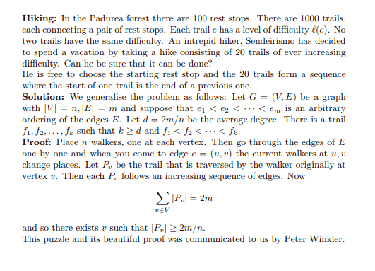

Can You Explain the Puzzle Toad Proof?
In summary, the proof is made clearer by going through the edges of E in order, starting with the shortest edge and finishing with the longest. At each stage, the walkers at the endpoints of the edge change places, with the possibility of having already moved along shorter edges. This results in each walker traveling along an increasingly longer sequence of edges. With a total of 2m edges traveled and n walkers, the mean number of edges traveled by a walker is 2m/n, meaning at least one walker must have traveled at least 2m/n edges. The Puzzle Toad site describes the proof as beautiful.
Carl1
Technology news on Phys.org
It would be easier to understand that proof if the second sentence was made more explicit:
Then go through the edges of $E$ one by one in order, starting with the shortest edge $\color{red}e_1$ and finishing with the longest edge $\color{red}e_m$ ... .​
At the $k$th stage of this procedure, when you come to the edge $e_k = (u,v)$, the walkers currently at its endpoints $u$ and $v$ change place by walking along $e_k$. If they have not previously moved then that will be the first leg of their walk. But if one or both of them have already moved during a previous stage of the procedure, they will have moved along edges shorter than $e_k$. When the procedure ends (with the walkers at the endpoints of $e_m$ changing places), each walker will have traveled along some increasingly long sequence of edges.
At stage $k$ of the procedure, two walkers travel along the edge $e_k$. So the total number of edges traveled during the whole procedure is $2m$. The number of walkers is $n$. So the mean number of edges traveled by a walker is $2m/n$, and therefore at least one of the travellers must have walked along $2m/n$ or more edges.
As the Puzzle Toad site mentions, it is indeed a beautiful proof.
Thank you so much. Now I understand the proof. It is beautiful.
