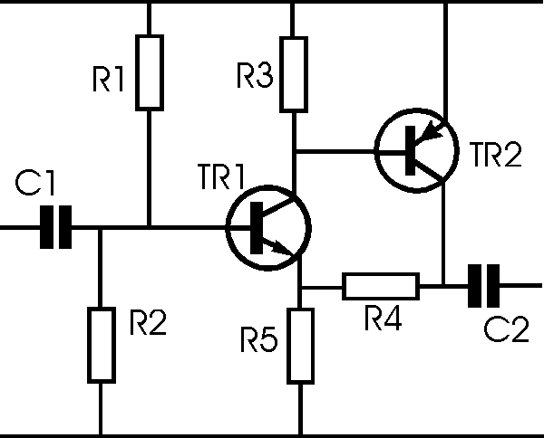

Can you explain this amplifier circuit to me?

I just want to know what you think (in order of when you think it) when you look at this circuit. I'll post what I think.
1) without input: Current goes through R1 and TR1 which allows more current to flow through R3, R4, C2 and R5 and to TR2. The current through TR2 inhibits the current that was already flowing through it to the output.
2) with input: slightly more current goes through TR1 some of which goes to the output
As you can see it's fairly limited. I don't really know what the capacitors do here.

That circuit would appear to have some issues. Where is it from? What is it supposed to be used for?

C1 is an input filter which blocks DC but passes an AC voltage to the base of NPN transistor TR1. R1 and R2 form a voltage divider that generates a fixed DC voltage which DC biases the base of TR1. When an AC signal is applied at the input, the passed AC signal adds with the DC bias voltage and hence the instantaneous voltage at the base of TR1 vibrates up and down around the DC bias voltage.
Then the instantaneous resistance of the collector-emitter path of TR1 changes in sync with the AC signal.
R3, R5, and the instantaneous collector-emitter resistance of TR1 form a second voltage divider circuit. Therefore the voltage at the collector varies as a function of the instantaneous resistance of the collector-emitter path of TR1. Resistors R1, R2, R3 and R5 control the amount of current flowing is both the base-emitter path and the collector-emitter paths of TR1. Typically the values are selected so that more current flows through the collector-emitter path than through the base-emitter path. Hence this circuit is a current amplifier circuit. In voltage terms, we could say that the instantaneous voltage at the collector of TR1 (i.e. the voltage across R3), varies more than the instantaneous voltage at the base.

I think it's a form of what used to be called a Complementary Feedback Pair - which gives high gain and low output impedance. It's a bit like the more familiar Darlington Pair which uses two npn or two pnp transistors for the same effect. I seem to remember that configuration was sometimes used as one half of a complimentary Audio output stage when only one type of high power transistor was available (or just for the hell of it).
It certainly isn't the best amplifier design to look at if you are not familiar with the simpler common emitter single transistor design. I suspect this is the case as you ask what the Capacitors are for.

It's 2 common-emitter stages in series, but with negative feedback from output to input.
This says the gain is 1+(R4/R5).

I don't think that's correct? https://en.wikipedia.org/wiki/Sziklai_pair would require R4 = 0 and R3 = infinity, no?
Not sure what I would call this circuit. It is hard to say without knowing resistor values. One thing is pretty clear. There will be virtually no voltage signal on the collector of TR1. That is not to say that it cannot be called 2 common emitters with negative feedback. It is likely the Zout of this amplifier will not be less than R4 + R5. The way I see it the voltage gain is higher than an emitter follower at the expense of a raised Zout. 0megatron I would say that R3 being infinity as you implied is simply a transistor 'package' not wired into a circuit as an actual amplifier. As the wiki link mentioned adding this resistor improves turn off time of TR2. Adding a resistor between the collector or TR2 and emitter of TR1 (in this case R4) should raise the gain because there is less negative feedback as compared with running without it. I would think it would also increase distortion. TR2 not having an emitter resistor moves the voltage gain to a less than predictable value. I don't believe the wiki link mentioned it but the Zin of this type of an amplifier should be higher than a plain old emitter follower. Interesting circuit. I have never built it or played with it. It reminds me of a PNP current boost transistor wired around a 3 terminal voltage regulator with the collector tied to the output.

Here is my short description:
1.) It is - in principle - one of the classical two-stage amplifiers with internal dc coupling and overall feedback.
2.) When emitter stages with npn transistors are dc coupled we have the disadvantage that the dc potential goes high from stage to stage (the collector potential of the first stage is identical to the base potential of the following stage, and so on...). For this reason the circuit uses a pnp transistor exploiting the well-known principle of "potential shifting with gain". It is easy to verify that the collector potential of TR2 is even lower than the collector of TR1.
3.) However, since TR2 has no internal stabilizing feedback, its collector current Ic2 is very sensitive to temperatur changes. For this reason, the negative feedback path R4_R5 stabilizes the DC quiescent point of the whole circuit .
4.) Both capacitors are simply coupling capacitors, which give rise to the following question: When the circuit must work for ac signals only, why we have internally dc coupling? Perhaps because the whole circuit is to be realized as IC? Otherwise, the classical approach for an audio amplifier is to appply ac coupling between the satges which has some advantages if compared with the dc coupling method.
Ok, I worked through it and confirmed that the AC gain is approximately 1+R4/R5 (assuming beta much larger than 1) and is not affected by R3.
Yes - this sounds logical because the gain without feedback seems to be rather large and, thus, the gain is determined primarily by the feedback network (as for opamps).
