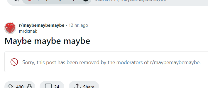

A pity the link to the video seem to have been removed.
The video is still there for me.
Huh. This is what I get:
Anyway, thanks for posting the video.
