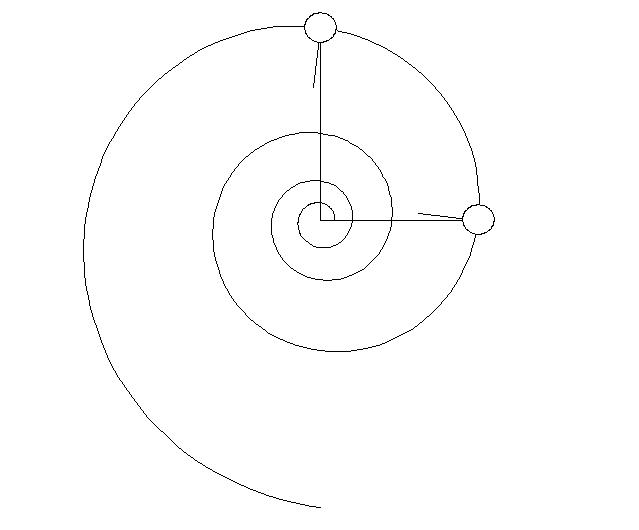

If a disk was rotating clockwise and then experienced a constant counter clockwise torque, the disk would experience angular deceleration, then angular acceleration in the counter clockwise direction. During the instant in time that the disk is not rotating, then there is zero centripetal acceleration.
For tangental acceleration, a puck sliding on a frictionless table and connected to string is a better example. Tangental acceleration is acceleration in the same direction as the velocity of the puck, and centripetal acceleration is perpendicular to the velocity of the puck. If the puck was sliding in a circle, and the string was pulled through a hole in the middle of the frictionless table, during the time the string is being pulled, the ball experiences both tangental and centripetal acceleration. The ball is moving in a spiral path (in this case inwards), so the string is not perpendicular to the puck during the time the string is being pulled inwards or released outwards. Example image - the short lines are perpendicular to the pucks path, and you can see that the string is not perpendicular:

With regards to angular acceleration with no centripetal acceleration, could you say that this happens when a pendulum is momentarily stationary when it reaches its maximum height?
Thank you :)
Extending the last comment I made on my previous post, is a pendulum an example of centripetal acceleration and angular acceleration together, or centripetal acceleration and tangential acceleration together... or all three??
... I think I may get it now. Please correct me if I am wrong, but are tangential and angular acceleration analagous, although not the same thing, because angular acceleration deals with how fast you cover angles but tangential acceleration deals with how fast you actually travel, and hence the tangential acceleartion is also dependent on the radius by a=rα.
So if you have a non-zero tangential acceleration, you also must have a non-zero angular acceleration, although they are not the same thing.
In the case of a pendulum, you have a tangential force of mgsinθ (where θ is the angle between the string and the downwards vertical) which also creates a torque because it is always perpendicular to the string, and you also have a centripetal force. However when the pendulum passes through the equilibrium position, the tangential force is zero and the centripetal force is maximum, and at the highest points the centripetal force is zero and the tangential force is maximum. Therefore you have a tangential acceleration (and so angular accceleration equal to the tangential accceleration divided by the length of the string) at all points except when the bob is at equilibrium, and you have a centripetal acceleration of v2/r at all points except when the bob is at its highest points.
