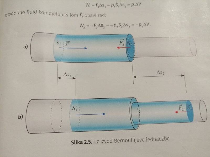

Can you please explain Bernoulli's equation?

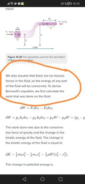

Can you please explain why is there work done by F2(on photo of textbook explanation of Bernoully equation (photo below)).

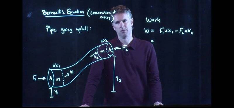

I can understand that W2 is caused by F2 which is gravitational force(screenshot photo from YT).

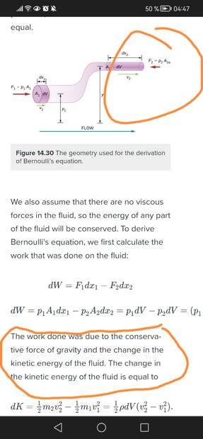

But for the explanation in textbook pipe is straight, no height difference, so what causes F2?
Is it the part of pipe that gets narrower(that "blocking affect", but shouldn't that be the cause for greater speed v2 compared to v1)?
Fluid in both cases(photos) is moving from left to right.
In textbook it's said that F2 is caused by surrounnding fluid, but how? If fluid is moving towards right side? And fluid is ideal(no resistance, not compressible).
Thank you.

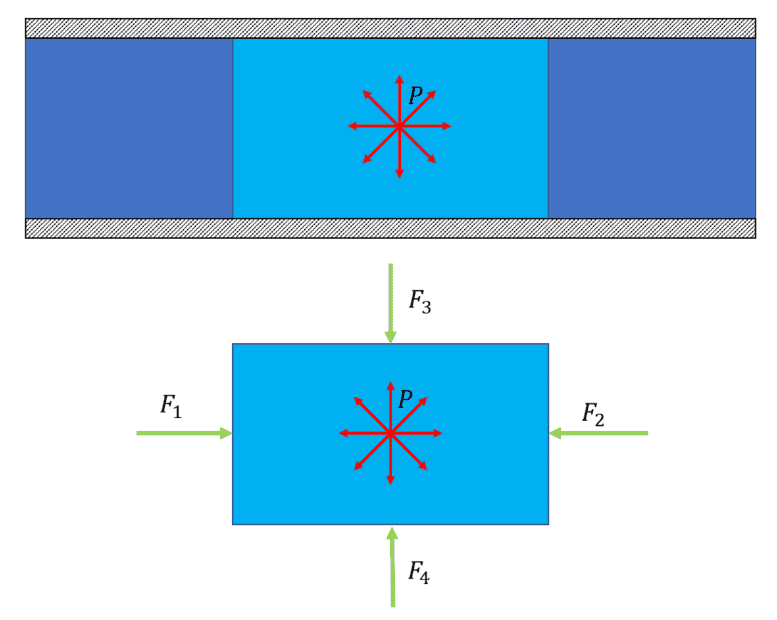

In the diagram below, the left side is what Bernoulli's says about flow through a straight section of pipe. If that section is the entire system according to Bernoulli's you can get any desired flowrate through that pipe at zero differential pressure. That is not consistent with reality, which is more like the right hand side-a statement of the first law that resembles Bernoulli's. If you desire more flow though that pipe in reality you must increase the differential pressure ( red bar labeled "s" for static head). That would then increase the energy lost (##T## for thermal energy) per unit length of the pipe.

Nope, just that it's less in magnitude than ##F_1## and that it has opposite direction
The surrounding fluid has a pressure, so it's going to apply a force to the fluid next to it.
Likes Callmelucky
vela said:
The surrounding fluid has a pressure, so it's going to apply a force to the water next to it.
What surrounding fluid? It's just water in pipe

Following @nasu's post, I notice that the pipe to the left of S1 appears empty. This suggests the fluid fills the pipe, left and right of the blue section. The colouring is just to highlight the fluid element being analysed.

So, you're saying that pipe is filled from both sides at the same time?

No. There is fluid moving left to right along the whole pipe. The blue colour just picks out the body of fluid being analysed in the equation.

I am not sure if we are on the same page but, fluid is allready moving in pipe and there is no friction. So force ##F_1## is causing acceleration, not steady continuous flow.

Yes there is acceleration, even in steady state. Because the pipe gets narrower, the linear velocity has to increase. Some force has to supply the energy.

My bad. I thought you were having an existential crisis with Bernoulli. The simple answer is ##F_2## exists, and you will learn more about why that is later!
They are looking at it like a small section within the total flow. The forces are the from flow that is external to the element pushing on it. There is both flow behind the element pushing the element forward with ##F_1 = P_1A_1##, and flow in front of the element that is pushing opposite ##F_1## given as ##F_2 = P_2 A_2##. It is resisting the push from ##F_1##. That net force acting on the element is what accelerates the flow along a streamline ##s##.
In Bernoulli's, this acceleration is not a time varying acceleration, it is a position varying acceleration. Bernoulli's does not hold if the flow is characterized as "unsteady", (varying in time).

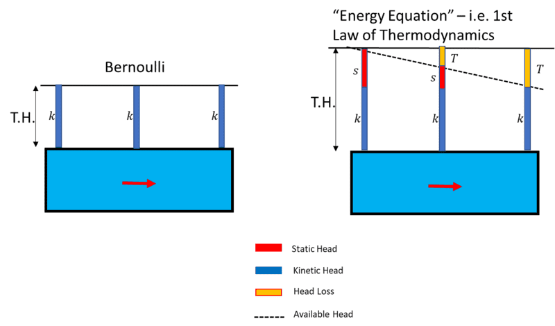

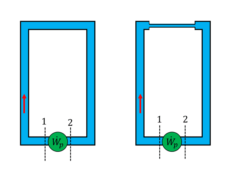

Here is an exploration to get an understanding of Bernoulli's limitations if you want to try.
What would Bernoulli's tell you the rate of work supplied by the pump in each of these two scenarios is when going clockwise with the flow around the loop from ##1 \to 2##?

Just apply Bernoulli's at 1 to 2 for each system. What do you get for the pressure differential across the pumps in each case. i.e. what is ##\Delta P = P_1 - P_2## in each system?
Then in general, the rate of work for the pump is given by:
$$\dot W_p = \Delta P \cdot Q$$
##Q## is the volumetric flowrate

Your intuition was headed in the correct direction for the power to circulate a real flow.
If this were a real system, we would expect the system on the right to require more power to circulate at any given volumetric flow rate, for one reason; Higher viscous losses per unit length - from higher velocity in the contraction.
However, I was hoping you would blindly apply Bernoulli's for this system and see what pops out of the theory for such a system.
The theory will deduce that neither of them will require any power to circulate any desired flow. The pumps will push whatever flow around the loop at no differential pressure and no expenditure of energy.

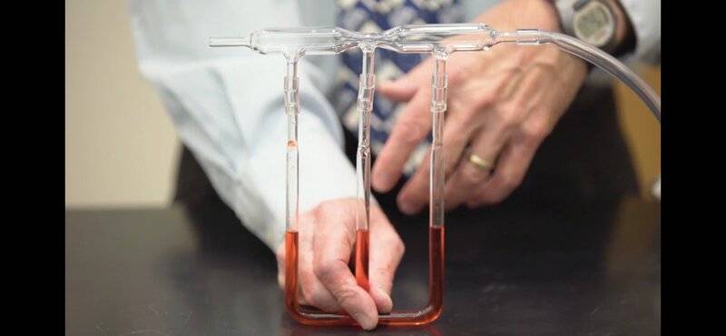

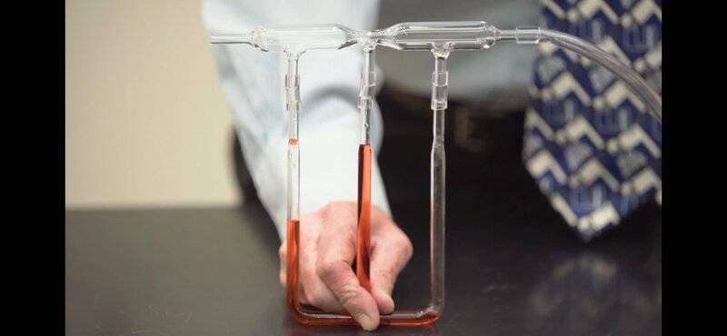

I believe I understand the differences, Hydrostatic pressure is due to depth on static fluid, static pressure in closed pipe with constant velocity is calculated by drilling a hole in the pipe and meassuring how high fluid rises in that pipe * ##\rho## * g + ##\rho## * g * distance of point in the fluid from top of the pipe, and dynamic pressure is same that but L shaped pipe is placed in tube and it's fixed so that pressure is higher than static, those two combined give total pressure.
So could it be that static pressure drops because the tube becomes narrower(static pressure drops with decrease of diameter of tube)?

Could this ##F_2##(pic in attachments) acting in opposite direction(thus doing negative work) be representation of loss loss of energy due to inelastic collision(kinetic energy is not the same before and after collision) between water molecules and tube wall(the one that gets narrower)? And gravitational force, ofc.

No it couldn't, they are assuming no loss of energy as heat in between 1 and 2.

for 1st scenario ##\Delta P=P_1 - P_2 = 0##.
But, for 2nd scenario I'd say that first pressure drops then increasesy but that is not what I have seen in experiment from YT, guy did experiment with venturi tube(pics in attachment) and I expected for 1 and 3rd pillar to be the same height, but they weren't.

In Bernoulli's they are the same height. It is an idealization of reality where there is no thermal energy lost between the two points in question. The experiment is conducted in reality, not in the idealization. So given that, what does Bernoulli say about the differential pressure across the pump in the second system?

Yeah but it can't be that big difference.
I mean, I can say what you have written and I believe it's true(that there is no difference), it's just that I don't understand why is then such a big difference between 1st and 3rd pillar or colored water.
Thats because of viscosity and air is also compressible. It adds a whole other layer of complexity to predicting the outcome of that experiment. Also "such a big difference" is a relative term here. The actual difference in pressure is , in terms of absolutes, small ( maybe 2"W.C. ?) , but clearly measurable. Furthermore, we have no idea what the velocity of the flow is in that experiment. Viscous losses go as ##\propto V^2##.
Bernoulli's pretends none of that exists.

But I still don't understand what causes that ##\F_2## because it's not viscosity and if the pipe is at the same height all the time than there is no gravitational force either.
The fluid element is being compressed by its container and the fluid surrounding the element. It's under pressure. Thus, when we isolate the element from its surroundings to analyze it, we need to replace the effect of the surroundings as external forces acting on the element. The net effect of all those forces (and others not shown-like weight) dictates whether or not the element is accelerating in a particular direction.
When you first started this, I was thinking you were seeing some seeming contradictions that can arise in certain systems where Bernoulli's gives spectacularly unrealistic results because of the inviscid assumption applied to an entire system. But, it just dawned on me (when you kept asking about ##F_2## and mentioned about calculating it in high school) that you probably just don't understand how we apply Newtons Second Law to analyze fluid systems. The average Mech. Engineers don't get into fluid mechanics until sophomore\junior year in college (I think). Sorry, If I caused any confusion in that regard. So lets back up, and I think we can get this resolved.
Likes Callmelucky
  • #36
Haha, I mean I don't know what I don't know. I read the link someone posted in comments and then I realised that I was thinking completely in the wrong direction. I figured that it's not pressure that fluid is causing on the pipes but the pressure in fluid, that was like heureka moment.
But last comment you posted
lost me completly.
Btw thank you for being patient and for explaining me stuff.
Can you tell me what you think I don't know?
  • #37
Callmelucky said:
lost me completly. Mostly because I thought that pressure is acting towards inside and not towards outside.
Imagine that parcel of fluid were instead a spring inside a non-rigid box. The fluid surrounding that package is under pressure. Its pushing on the boundaries of the box which contains the spring. The spring is being compressed. If we take the spring out of the fluid would decompress (expand). So...if we are going to analyze it as it were inside the fluid, then outside the surrounding fluid we need to apply forces to the spring to keep it in its compressed state. When we isolate a system, this is what we are doing. We are removing everything around that system, and replacing what everything does to that system with forces.
Likes Callmelucky

Likes Callmelucky
  • #45
Mechanical energy within the fluid remains the same, if we consider the Bernoulli’s idealization of an isolate system (no energy supplied in or sustracted out the fluid).
What and how we measure the three ways in which that energy manifests itself is not the same as that energy.
What you have described in your explanation is what we can see when fluid comes to a stop inside the vertical pipe or the L shaped pipe that you have mentioned.
The same applies to the picture that you have posted showing the transparent tubes arrangement.
If the height in the left side vertical tube is significantly less than in the right hand one, some residual velocity must remain at the point where vertical and horizontal tubes meet, which is stealing some potential energy from the vertical column.
Regarding discussed F1 and F2, independent from the source that induces that imbalance, they must exist if the fluid is moving in an accelerated manner.
If the fluid is static or moving at constant speed, F1 - F2 = 0.
Likes Callmelucky and erobz

yes, and didn't understand much of what wikipedia said
But I feel better now that I know it's something I am not supposed to know. Thank you very much for explaining this to me
As I said earlier, I just wanted to know where it comes from(I don't need to completly understand it) becauee it's not said in textbook but F2 is there so that bugged me a lot.
If it's too complicated and way beyond high school curriculum then I accept that ##F_2## is there and I don't need to completly understand it , but I asked this question because I thought it's something simple that is not explained in tectbook
