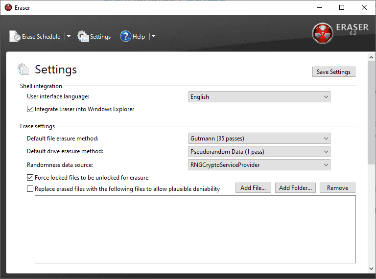

It can still be retrieved unless serious efforts were made to erase the data. Certainly, the FBI has tools to recover files that were simply modified once and deleted. I don't know who else would have those recovery tools.
jack action said:
If so, would it at least make it a little bit harder to find or would the computer overwrite the erased content faster?
Yes, it makes it harder. A casual effort would not recover the data. But If you want to do a better job of erasing data, I recommend using a tool like Eraser by Heidi. It will overwrite a file several times with random bits. There are several options for overwriting the files:
A final option is the total physical destruction of the drive.

Windows has a full reformat of a drive. It's my understanding that their quick format just cleans out the directory. It takes a long time to do a full reformat a large drive.
The Eraser tool that I referenced above allows you to overwrite the blocks of an individual file many times. And you can make Eraser an option for the files in Windows Explorer.
Don't forget about backups of the file. In general, I recommend that any sensitive information be kept in an encrypted drive with a strong password. That way, your backups are as well protected as the original. I use VeraCrypt by IDRIX for that.
