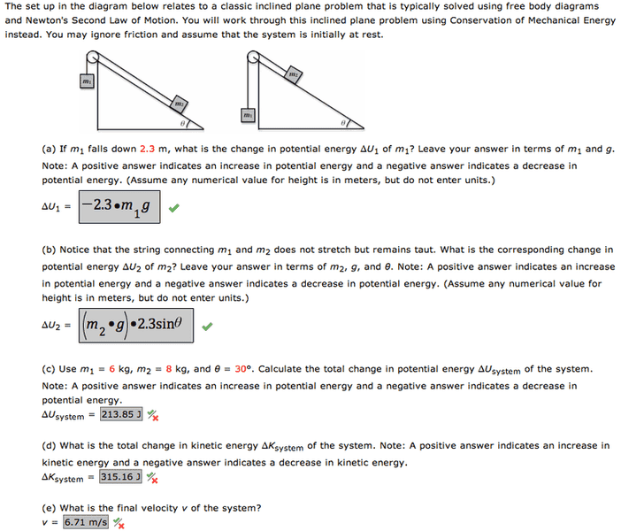

c, d, and e I don't know how to solve
For d I tried doing
vf2 = vi2 +2ad
Vf = √(2*9.8*2.3) = 6.71 m/s
Assuming the inclined plane is frictionless
Since m2 is roped to m1, it's velocity up the ramp will be 6.71m/s too
The total increase in KE is then 0.5[8+6]*6.71^2 = 315.16 J
"INCORRECT"
Right now I need a genius to tell me how to get the answer ASAP -.-
Since (d) is wrong, so is e. -.-
Story of my life.

For (c), how did you get that number? Isn't it just the sum of the two ΔU values?

m1 falls 2.3m and therefore has -6*9.8*2.3 = -135.24 J difference.
m2's PE increases 8*9.8*sin 30° = +39.2 J difference.
The total change then is 39.2 - 135.24 = -96.04 J
^ That was my previous answers, but I got that wrong too...
So I'm pretty much screwed.

You left off the 2.3 for m2...
(c)
m2's PE increases 8*9.8*sin 30°*2.3 = +90.16 J difference.
The total change then is 90.16 - 135.24 = -45.08 J
Ok so how does this relate to part d and e though? How would I solve for those two last ones?

(d) asks for the change in KE. Since the system is frictionless...

But you had the wrong answer for (c) before. Now you have that right.
What is the total energy of a system in terms of the potential and kinetic energies? If the system is lossless (no friction), what can you say about the total energy over time...?

KEinitial + PEinitial = KEfinal + PEfinal
KEinitial + PEinitial = 0 + 0 (No friction)
KEinitial + PEinitial = 0?

Rearrange so you show the relationship between ΔKE and ΔPE...
KE = -PE
KE = -mv?

If you put Δs in front of your first equation, you would be on the right track...
Consider the total energy over time which is a constant. Hence change in PE must balance out change in KE. The rest is obvious.
As for (e) consider that you have a final change in KE, as well as the masses. You can now plug that into solve for velocity.
