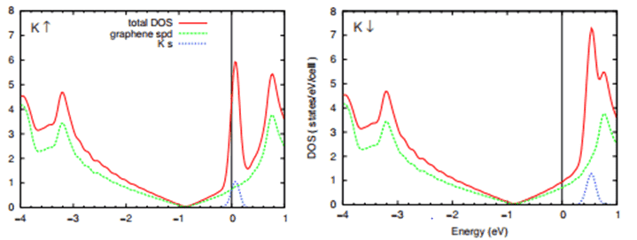

  1. In the paper, they said, "Figure 4 shows the same K-graphene DOS near the EF along with the projection of the DOS onto graphene and the K s state. The spin-up 4s peak lies close to the Fermi level and is partially occupied, while the spin-down 4s peak lies approximately 0.5 eV above EF and is unoccupied." I pasted the picture below for reference.
Question:
-How did they know that this blue peak is the K 4s peak? I am thinking it is because the electronic configuration of potassium is [Ar] 4s1, but I am not sure.
2. It was also said in the paper that "There is no evidence for hybridization between the K 4s peaks and
the graphene states; the PDOS of the graphene shows no peaks near the K 4s levels. Furthermore, the broadening of the K 4s peaks due to interaction with the graphene is small.
Question:
-How do we say that there is hybridization between the K states and graphene states? My assumption is that there should be a green peak at same energy level (same x coordinate) as blue peak. Again, I am not sure about this.
-How do we qualify that the broadening of the K 4s peaks is small? (i.e. What does "small" mean?)
-What is the significance is there is broadening of a peak in DOS? What does it physically mean?

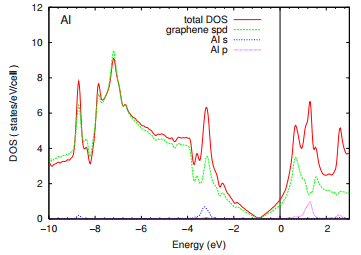

7. The paper said, "The 3s state of Al appears to split and hybridize with the graphene states at −8.6 and −3.3 eV relative to EF."
Question:
-Is the peak of graphene that is directly above the Al s peaks the reason why the author inferred that the there is hybridization?
8. The paper said, "The Al 3p peak lies 1.3 eV above EF and is noticeably broadened due to the Al-graphene interaction."
Question:
-Related to my question in item #2. How do we say that the peak is broadened? Is there a numeric criteria?

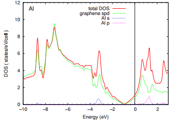

11. The paper said in relation to Fig. 6 which I pasted below, "Because the graphene states are strongly altered, the Dirac point is no longer evident. "
Question:
-I thought that the Dirac point is the point where the DOS is zero. From this graph, the Dirac point seems pretty evident to me, so why is the paper saying that the Dirac point is no longer evident? Am I missing something about the definition of Dirac point?
12. The paper said in relation with the figure above, "The DOS illustrates that approximately two electrons are shifted from the 4s states in atomic Fe to the spin-down 3d states in the Fe-graphene system"
Question:
-My understanding is that the two electrons lost by 4s states was inferred from the fact that the 4s peak is above Fermi level. What I do not understand is how the author figured out that the two electrons shifted to the 3d states and not to other states, such as the graphene states.
