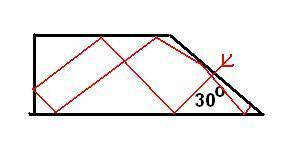

The answer is "almost". You can reach reflectivity with internal total reflection much better than that of mirrors. There are optical resonators which trap light for a while. The lasers consist of such a resonator with a small opening on one of the end mirrors. Closing the output, the light is trapped. Think of fibre optics or other waveguides. The light is confined between the walls all along the length of the fibre or waveguide by the total reflection, and escapes at the open end. Of course, no surfaces are perfect, and no materials are completely free of absorption, so there will be some loss and the energy of the trapped light is dissipated sooner or later. But it is worth to show the students an experiment with a prism and laser pointer to demonstrate total reflection. With a prism of shape shown, at certain position and angle of the incident ray one can make the prism glow without any visible outgoing ray of light.

Echoing ehild, total internal reflection is used in optical fibers, which are nearly lossless at telecommunications wavelengths (0.2 dB/km). Cavity ring-down spectroscopy also uses high-finesse cavities (reflectivity = 0.9999 appears to be common).
These roughly translate to light 'trapped' for 1.6 ms (fiber, starting at a 100 dB SNR) and 12 us (CRDS, 1-meter long cavity).
Thank you Andy Resnick! Although that 1.6 ms is almost infinitely long with respect to the period of light, it is very short with respect to our lifespan :smile: But everything is relative...
