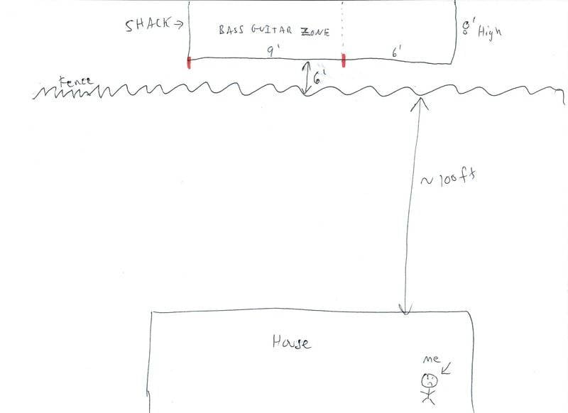

Hello Physics Folks:
Having gotten a C in college physics, I figure you're better equipped than I to solve this problem, and I also imagine I've made it far
more complicated than necessary. 😬
SCENARIO: I live in a house in LA. 100 feet away in my backyard is the property line, separated by a wood fence about 5.5 feet high.
On the neighbor's property, set 6 feet back from the fence is a shack made of wood.
The rectangle face of the shack facing my property is about 8 feet high x 15 feet long.
And therein lies a neighbor who plays his bass at night and it's annoying as heck.
The bass mostly seems to emanate from the left of the shack, meaning the sound mostly comes from an 8’ x 9’ area.
According to an iphone spectrum app, the bass is putting out chords between 65Hz and 130Hz at about -70db directly outside the shack wall.
Multiple requests to the neighbor to lower the volume or install bass traps have been ignored.
We'd rather not file city complaints and start a war, and LAPD doesn't care anyway.
Hence, a DIY solution is needed. Here's my thought and perhaps y'all will improve upon it.
The good news is the back of the shack faces my property and the 6 feet between the shack and the fence is pretty much inaccessible from THEIR side due to overgrowth on both side of the shack. But I can access that area.
I understand that “mass-loaded vinyl” dampens bass. What if I were to get some MLV, mount it on three thin pieces of waterproofed wood (each measuring 8’ x 3’) and just lay them flat against the back of the shack?
He'd never know it was there. The question is will MLV work and if so, what thickness?
I've attached a highly professional sketch of the scenario. The red lines are the area I'd aim to cover.
Your help is appreciated!!!
You cannot really cancel or absorb low frequency noise. Build a heavy 90° 'V' shaped, or a curved wall, close to the noise source, something that will reflect the noise back to their property.
Emphasis on “heavy”. You need a wall (concrete or cinder blocks, e.g.) that will not vibrate from the bass noise that you are trying to reflect.

It should be easy to stay on your side of the boundary fence, which is 6' from their shack, and 100' from your house.
Build a 'V' shaped, or a curved wall, so it is rigid, and does not vibrate.

Problem is that low frequency sounds will diffract around any wall - however heavy. There are two solutions here. You have to enclose either your neighbour or yourself in a continuous wall in a massive box.
