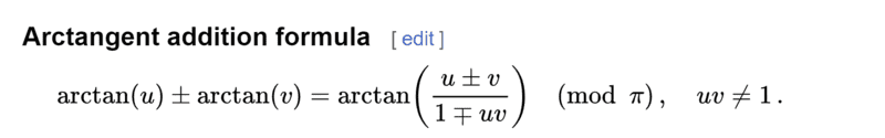

What is the meaning of ##(mod ~ \pi)## in the formula given below? This formula is taken from https://en.wikipedia.org/wiki/Inverse_trigonometric_functions

My understanding is that it probably means either ##+ \pi## or ## - \pi##, so that ##\pi## is either added to or subtracted from the first term, just like ##|x| = \pm x##.

Look at the pictures here:
https://de.wikipedia.org/wiki/Arkusfunktion
##x \longmapsto \operatorname{arctan}(x)## is not only possible on its main branch between ##\pm\dfrac{\pi}{2}## but also below and above. We have ##\tan\left(\alpha + \dfrac{\pi}{2}\mathbb{Z}\right)=x,## i.e. infinitely many values of the tangent function map to the same function value. The inverse "function" can therefore be defined on any interval ##\operatorname{arctan}(x) \in \left[n\dfrac{\pi}{2},(n+1)\dfrac{\pi}{2}\right]## for some ##n\in \mathbb{Z}.##

Does this mean that we are adding an integer multiple of ##\pi## to the first term in the formula mentioned in question where an integer could be any positive or negative integer including 0?

The inverse tangent function has only unique function values in an interval of length ##\pi##, usually, ##\left(-\dfrac{\pi}{2}\, , \,\dfrac{\pi}{2}\right).## Since ##\tan\left(\alpha+ \pi\mathbb{Z}\right)## is the same real number, we cannot uniquely determine one number as its inverse. We first have to determine in which interval our angles are. E.g. ##\operatorname{arctan} (\pi / 3)\approx 0.81.## Therefore
\begin{align*}
\operatorname{arctan}(\pi/3)+\operatorname{arctan}(\pi/3)&\approx 1.62 \\
&=\operatorname{arctan}\left(\dfrac{\dfrac{2\pi}{3}}{1-\dfrac{\pi^2}{9}}\right)\\
&=\operatorname{arctan}\left(\dfrac{6\pi}{9-\pi^2}\right)\\
&\approx \operatorname{arctan}(-21.676)\\
&\approx -1.5247
\end{align*}
which is obviously wrong. However, ##-1.5247 + \pi \approx 1.617## which is pretty close to ##1.62## if we consider all the approximations I made. So ##\mod \pi## means that the left- and right-hand side of our formulas can differ by ##\pm \pi.##

In general, (mod ##\pi##) means ##\pm n \pi## for some ##n \in \mathbb N##.

Shouldn't ##n \in \mathbb Z##? Oh, I get it since you used a plus minus before ##n##.
Likes fresh_42
Yes, but the ##\pm## does that.
