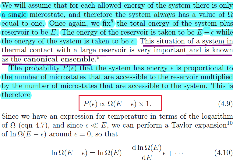

The probability that the system has the energy ε i.e.P(ε).
The system could have any energy between 0 and E.
So, P(ε) = 1/(no. of possible systems with different energies)
I cannot understand how P (ε) is related to the no. of possible microstates the reservior could have with energy ( E - ε).
In eq.4.10, it is differentiating wrt. E. But, E is constant. So, dE is 0. What about this?
I have taken the image from Blundell's book.
This is not correct. The probability is P(ε) = (# of possible arrangements where the energy of the system is ε) / (total # of arrangements)
The numerator is thus ##\propto \Omega (E - \epsilon)##.

The no. of possible arrangements of the smaller system with energy ##\epsilon## is 1, while the no. of possible arrangements of the smaller system and the bigger system is ##\Omega (E - \epsilon)##.
I think you mean by "# of possible arrangements where the energy of the system is ε)" the no. of possible arrangements of the smaller system and the bigger system is ##\Omega (E - \epsilon)## instead of no. of possible arrangements of the smaller system with energy ##\epsilon## is 1.Why so?
Pushoam said:
Suppose that we can describe the whole system + reservoir by a microcanonical ensemble. Then, the probability of the system being in a particular configuration of energy E is simply proportional to the number of ways of depositing the remaining energy U-E in the reservoir. How?
I don't understand your question. The total energy is ##E##, which is distributed among the systems (##E_s = \epsilon##) and the reservoir (##E_r = E - \epsilon##). The total number of microstates for each value of ##\epsilon## will thus depend ##\Omega_s(E_s)## and ##\Omega_r(E_r)##.
##\Omega (E - \epsilon)## is the multiplicity of the reservoir, not system+reservoir (using the notation above, ##\Omega_r (E - \epsilon)##).

In other words, you have to calculate the conditional probability ##P(\epsilon | E_r = E - \epsilon)##.
This I am not getting.
I want to calculate the probability that the smaller system will have energy ##\epsilon##.
Whenever the small system has energy ##\epsilon##, the reservoir has to have the energy ## E - \epsilon##.
I think ##P(\epsilon | E_r = E - \epsilon)## means : the probability that the smaller system has energy ## \epsilon## , when it is given that the reservoir has the energy ## E - \epsilon ##. But, in this case ##P(\epsilon | E_r = E - \epsilon)= 1##.
Is this correct?
I think I have got it now.
The smaller system and the reservoir together can be described by a Microcanonical ensemble as its energy E is constant.
Acc. to the fundamental assumption of stat-mech , each microstate corresponding to Microcanonical ensemble is equally probable.
Let's say that the smaller system is allowed to have n no. of different energies and so n no. of microstates.
Then the probabililty that the smaller system is with energy ##\epsilon## and the reservoir has energy E- ##\epsilon## is
denoted by P(##\epsilon##).
Now, ## P(\epsilon) = \frac {(\text{ no. of microstates of the smaller system with energy} ~ \epsilon )* (\text{no. of microstates of reservoir with energy }(E- \epsilon))} {\text{total no. of microstates of the microcanonical system}}##
##\\ ~~~~~~~~~~~~~= \frac {\Omega_s (\epsilon) \Omega_r (E-\epsilon)}{\Sigma_i \Omega_s(\epsilon _i) \Omega_r(E-\epsilon _i)}##
## ~Since, \Omega_s (\epsilon)= 1 \text{given in the problem }~,
\\P(\epsilon) ∝ \Omega_r (E-\epsilon)##
Is this correct?
As you figured out afterwards, this is not correct. ##P(\epsilon | E_r = E - \epsilon)## is a function of ##\epsilon##, because the multiplicity of the reservoir is a function of ##E_r## (and hence of ##\epsilon##).
Is this correct?
Correct.
